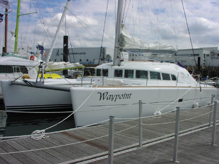

    The Catamaran Company has heavily promoted the partnership on its website (www.catamaranco.com), beginning with a front-page article about Waypoint, the first of the two 41-footers off the production line. The second electric Lagoon, expected in November, is named Paradigm. Catamaran Company President Hugh Murray states in the website article that “Waypoint marks a new beginning for the catamaran industry and places The Catamaran Company in pole position to combine the might of the largest yacht manufacturer with their reputation as the leading catamaran retailer in the world and deliver a new catamaran that exceeds expectations in cost efficiencies and sailing performance.”

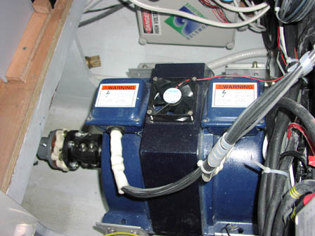

    20,694
    Soloman Electric Motors mounted in each sponson. Due to the reduced size of electric motors over internal combustion engines, the shaft exits the hull at a reduced angle, thus placing the thrust line more parallel to the running surface. This increases efficiency.

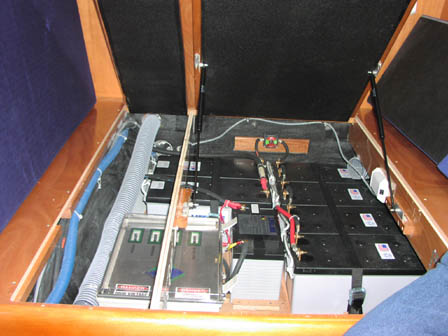

    20,694
    Banks of batteries mounted midship to increase stability...

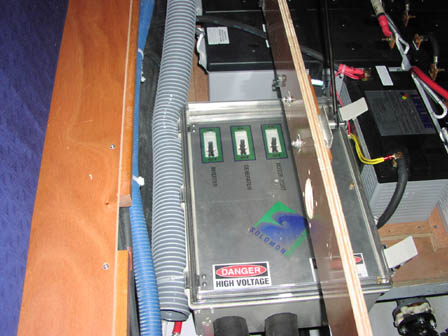

    20,694
    The power converter...
