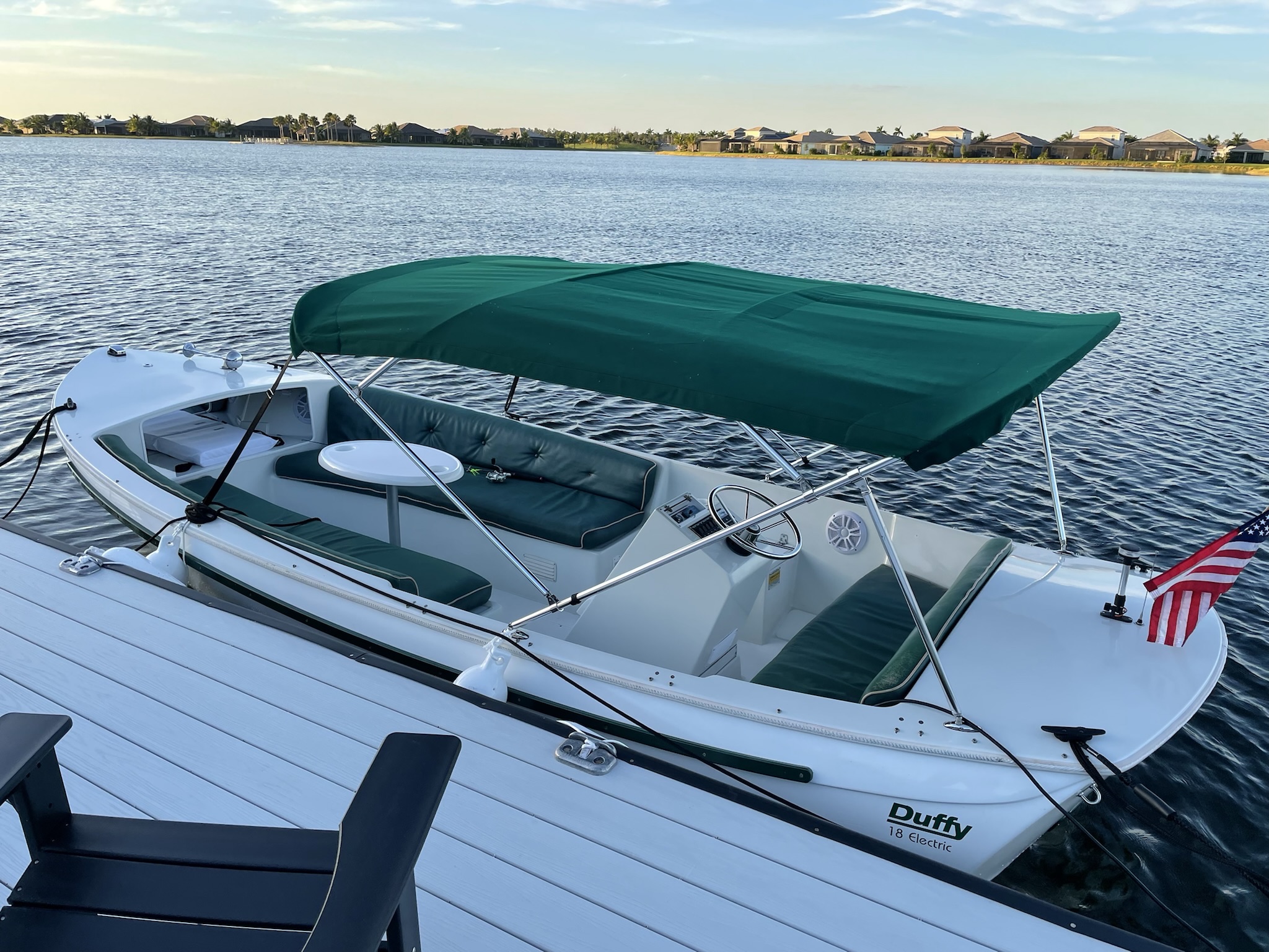

    Thanks Rob! Great to know. I have a 1992 Duffy Electric 18 footer. It is mostly restored and I am in process of updating the entire motor assembly area, electronic controller, etc. IMG_5078.jpg and cutless bearing.

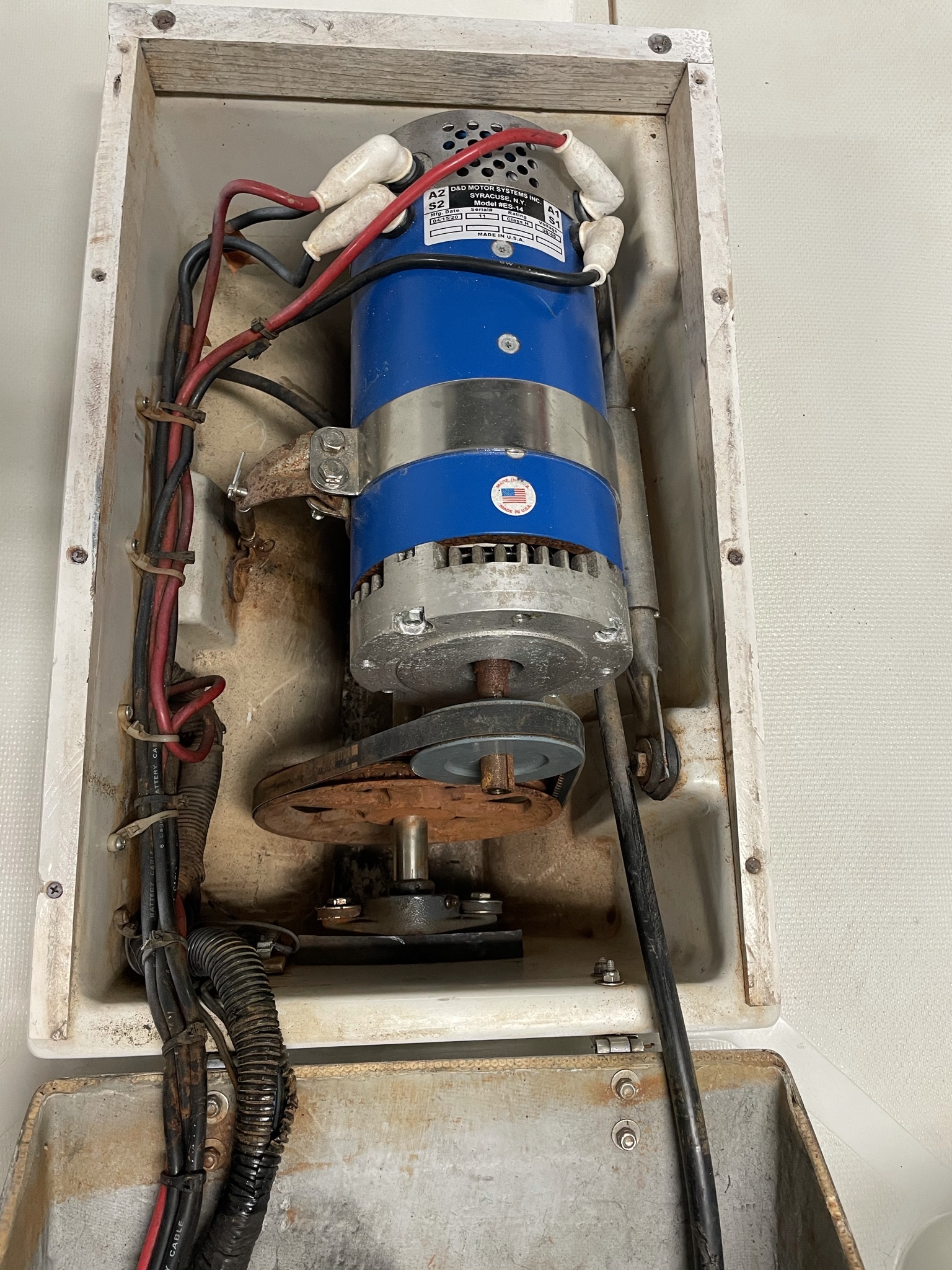

    Here is the "before" image of the motor area. The motor is about 2 years old but everything else needs updating. IMG_4490.jpg

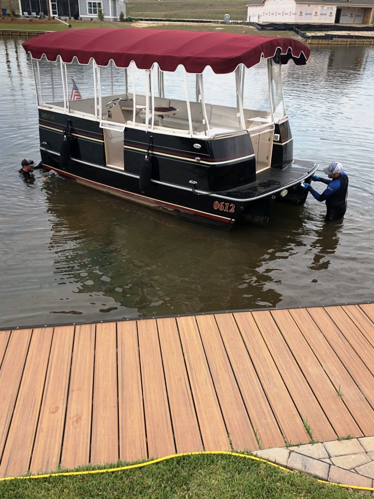

    Doug, that's a beauty! Here's my 2010 Duffy M160, which I use on a 300 acre inland lake with no-wake restrictions in coastal South Carolina. It's a perfect boat for tooling around on this lake, especially during cocktail hour. It's also different than your typical pontoon boat, which I appreciate.
    So, what are you planning to do for the controller, throttle (aka actuator), etc?

    Thanks Rob, I will for sure post some pictures as I proceed with additional repairs. So far, I have done the following:
    • New batteries and motor (installed by the previous owner in 2020
    • New motor controller - I installed recently - the old one worked somewhat but was failing
    • I am replacing the cutless bearing by the prop
    • I am refurbing the motor area to include a new large sheave/pulley, new front bearing, and new dripless seal. I will also clean up the entire area.
    Thanks, Doug

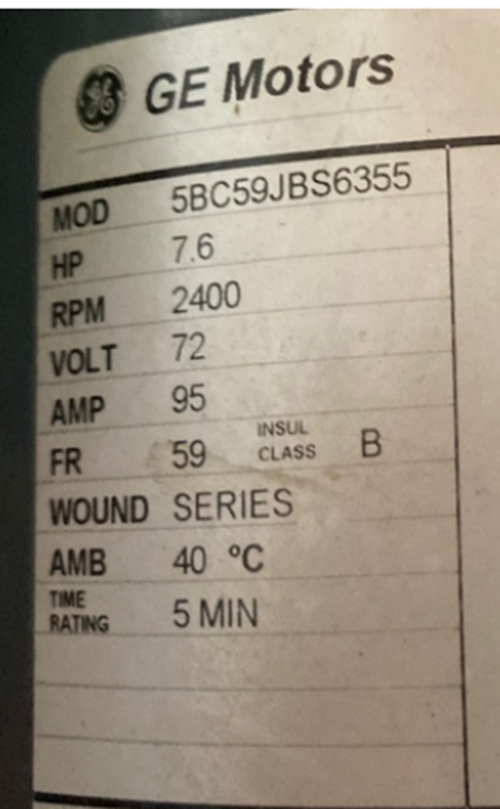

    I'm hoping for some help with my electrical calculations. My motor sticker is below, it says 95 amps. Despite saying 72V, I believe this has always been a 48V system using six 8V batteries. The existing 8V batteries each say 145AH @ 5 HR, so the combined six battery system would be able to output 174 (145/5 * 6) amp-hours for 5 hours, correct?
    I’m converting to four 12V batteries and want to have 2 hours of runtime (our lake is very small, one hour is the actual max). At 95 amps I need 180 amp-hours total, or 45 amp-hours from each 12V battery, correct?

    That 95A is the rating for the maximum amps drawn by your motor. What you really need to know is what your actual amperage draw is when running at your normal cruising speed. Keep in mind that flooded lead acid (FLA) batteries don't like to be drawn down below half of their capacity. Routinely drawing down below 50% will severely limit life of the batteries. Also, your Amp-hour rating of 145 Ah per battery doesn't multiply by the number of batteries when they are connected in series. 4 12V batteries connected in series will get you 48V, but still with only 145 Ah for the total battery bank.
    Considering the 50% guideline, you really only have about 75 Ah to work with, so if your motor is actually drawing 50 amp at your cruising speed, you can expect the run the boat for about an hour and a half, and that's with new or nearly new batteries. Less with older batteries.
    Are you sure your Electracraft isn't using the GC2 golf cart batteries, which are 6V batteries? In other words, 8 6V batteries to get you to 48V? IMHO, if you are sticking with FLA batteries, I'd stay with whatever your boat originally had. The GC2 batteries are well suited for these boats (I've got a Duffy), have a 200 Ah rating, and are relatively inexpensive.

    Thanks Rob. My boat (an ElectraCraft not a Duffy) came with my house and since I've owned it has always had six 8V batteries (T-875s). I appreciate you correcting my multiplying Amp-hours and I think I understand now.
    I'd like to switch to AGM Deep Cycles for the many benefits in Fishtigua's link, especially the no maintenance and surviving a freeze.
    Assuming I am going AGM, I'd appreciate any comments on the pros/cons of using four 12Vs vs six 8Vs as well as recommended brands.
