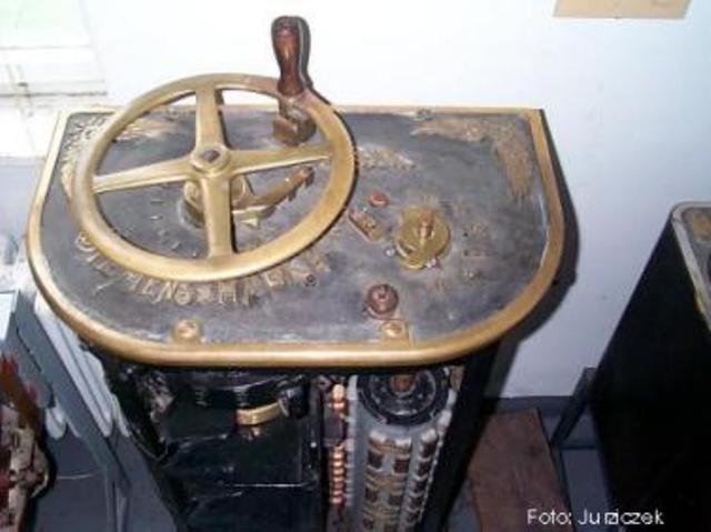

    Take that one, it is for sale and it will never fail on you, promise. It worked flawless during its former life for more than 100 years :D.

    Let me guess: From an old street-car or tram in Europe?
    Sure, I am all for simplicity but it probably weighs more than the boat and the owner and would slow me down..;)
