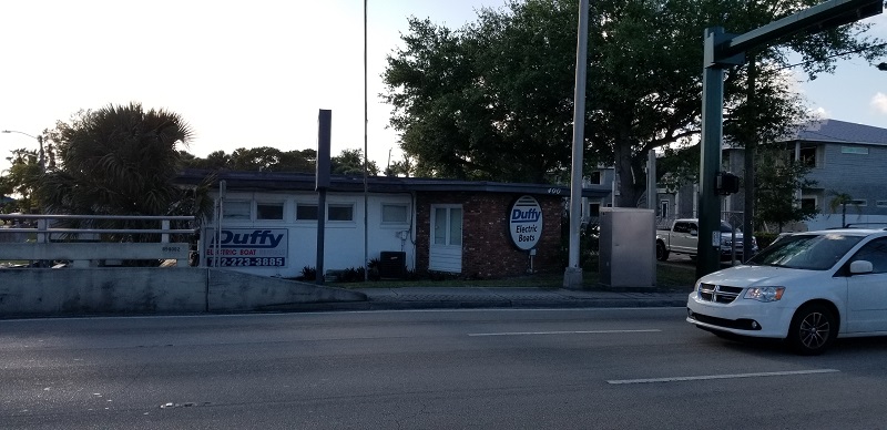

    I keep driving by this place. Is this shop still supportive?
    In Stuart FL at the S W corner of Ocean Blvd and UseLess 1.

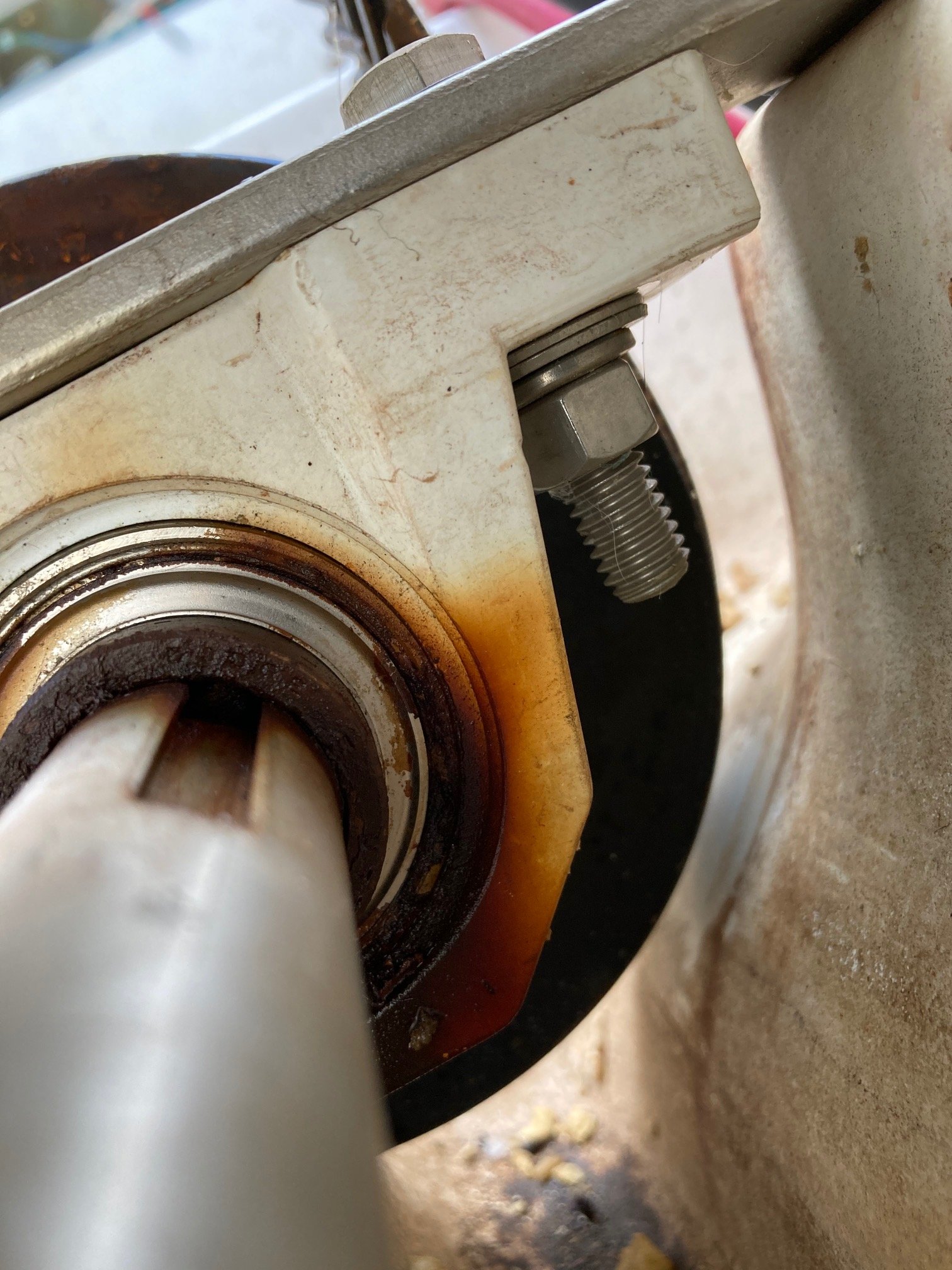

    Hello from Colorado, where I can't find anyone to work on an electric boat.
    We have an ElectraCraft LSR 18 that was running very noisy. This thread has been awesome, thanks everyone.
    The motor was most of the noise but I also noticed the forward bearing doesn't look great. Please see the attached picture. Would you recommend this be replaced?
  4. Norseman
    Norseman Senior Member
    Feb 24, 2005
    3,584
    Palm Coast, Florida
    Ouch…:confused:
    The short answer is yes: You are looking at good old rust stains most likely from low grade steel.
    Yes, remove the bearings, lock-washers, whatever the bad metals are, then replace with better quality steel.
    This is very low tech, a shaft, a bearing, a seal etc, easy to fix, but it may be involved if you need to haul at a yard, hire mechanics with pullers and other specialized tools.
    Do it yourself, easy peasy if you have the experience and the tools.
    (Guessing you don’t since you found this page and asked the questions. Sorry.:cool:)

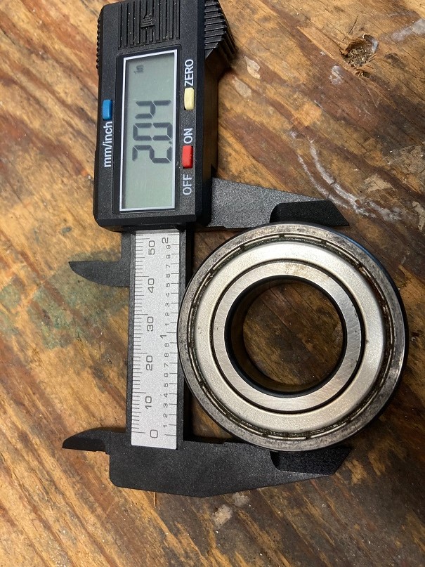

    I opened the motor and found the bad bearing. Unfortunately, it doesn't have a part number on it.
    My budget caliper is showing .98" ID, 2.04" OD, .59" wide. There are tiny notches in the outer ring, if those are separating the balls then there are 15 balls. This is a GE motor from about 20 years ago. Any suggestions for choosing a replacement bearing?
    I appreciate the help so far, I'm having fun and making progress.

    Generic bearings are probably ok.
    Unless Chinese knock-offs using bad metals and cheap everything else.
    Always heard good things about SKF:
    https://www.skf.com/group/support/splash
  10. DOCKMASTER
    DOCKMASTER Senior Member
    Feb 26, 2012
    1,661
    Ketchikan, Alaska
    If your Amazon bearing doesn't work just take your old one into any decent bearing shop and they should be able to measure it and find you one. I have always been partial to Timken or SKF bearings myself.
