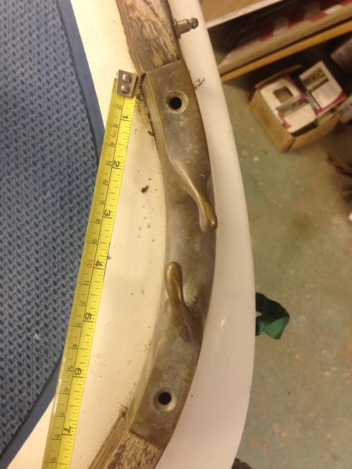

    I am looking for a part that comes from the W.D. Schock era. The curved brass/bronze toe rail chock at the stern of the boat that sits at the corner of the teak toe rails.

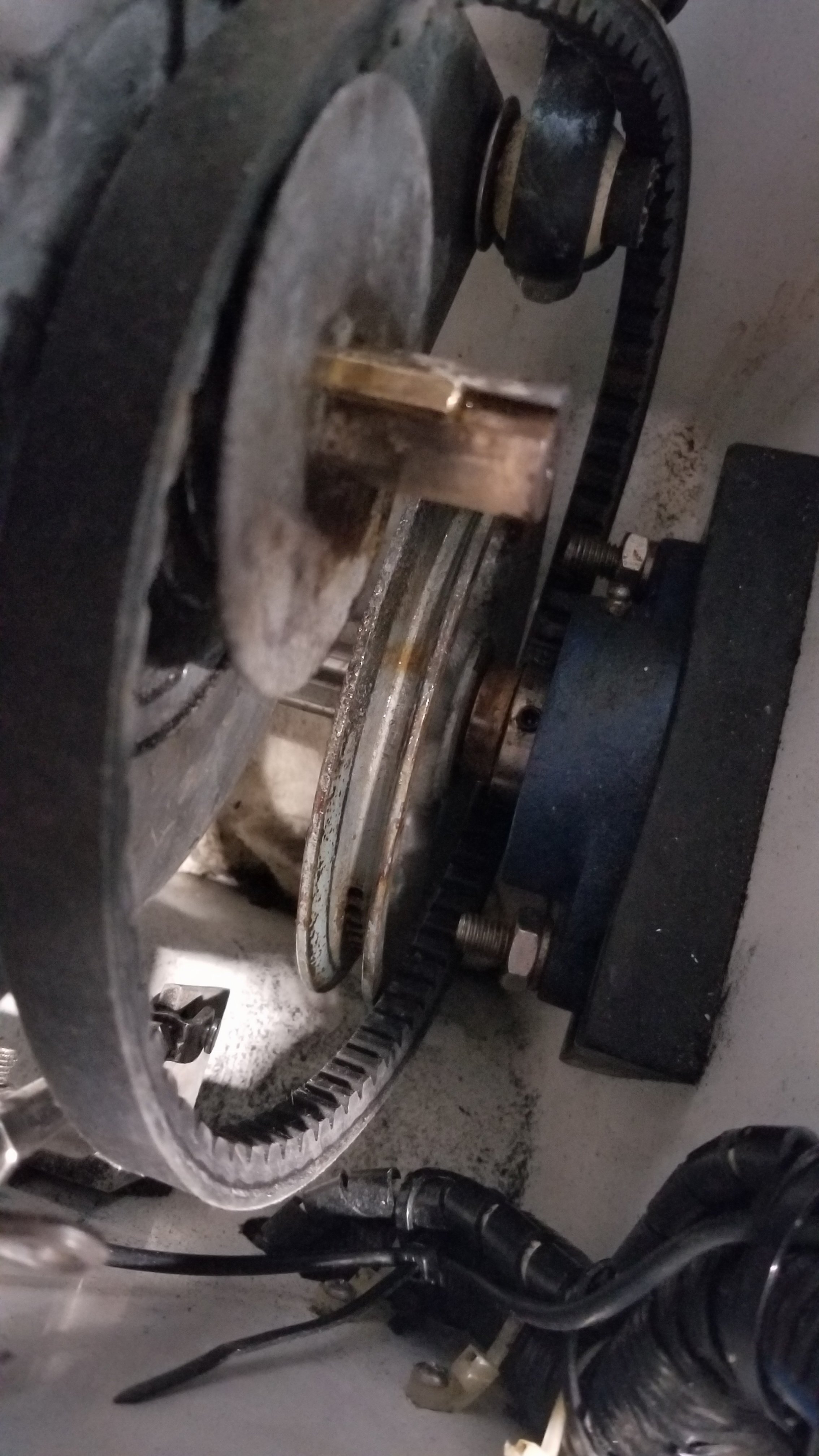

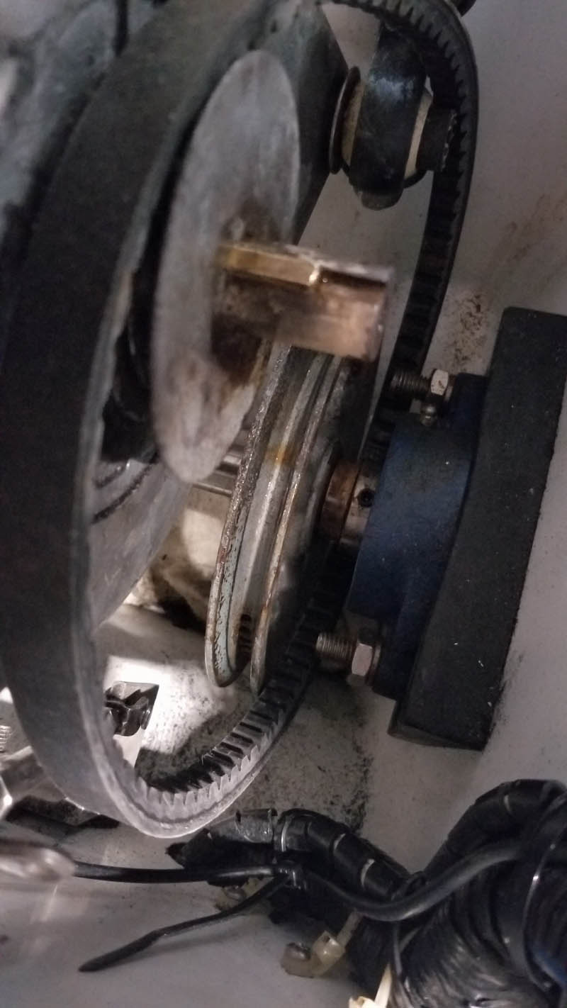

    Hello all,
    New owner of a used 21' Duffy Cruiser. Very glad to have found this forum, thank you for adding me.
    I'm looking to replace and align drive belt. Should drive shaft bearing be removed, or should I remove the entire bearing assembly from the motorbox/bulkhead? Does the packing gland need to be loosened (the large brass nut around the shaft?)
    Very new to this, and inboard propulsion in general, not even certain of terms/identifying parts. Having difficulty finding any motor/drive train schematics, any available anywhere?
    Thank you for any help!
    Jason
  14. Fishtigua
    Fishtigua Senior Member
    Jul 20, 2007
    2,934
    Guernsey/Antigua
    Hi, and welcome along with our journey, we are all learning.
    Dag will be along shortly, with his Scandi swear-words but they are all true. Loved my Duffy, perfect for the Yacht Club.
  15. Norseman
    Norseman Senior Member
    Feb 24, 2005
    3,598
    Palm Coast, Florida
    Welcome aboard Alaketrick.
    Can’t help you much as I never worked on a 21, only knew my 18 Balboa, and I had to pull the shaft back to fit a new belt. Alignment was done with the motor.
    Don’t loosen the packing if you can avoid it, it needs to be adjusted while in the water anyways.
    Post a few photos of your shaft, belt, pulleys etc, easier to help then.
  16. alaketrick
    alaketrick New Member
    May 28, 2020
    3
    Michigan
    Hi Norseman,
    sorry, it was a few days before I saw your response. thank you.

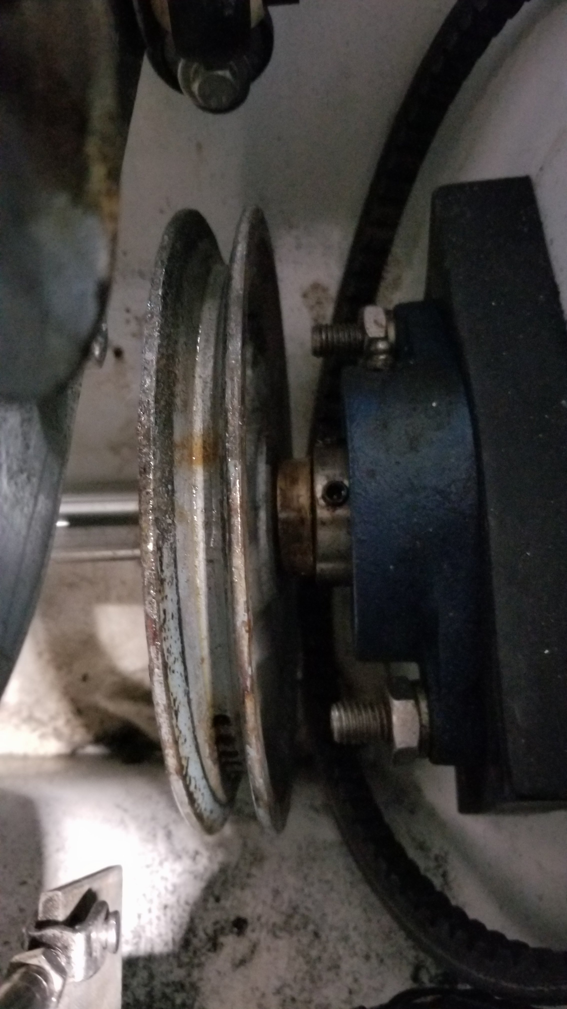

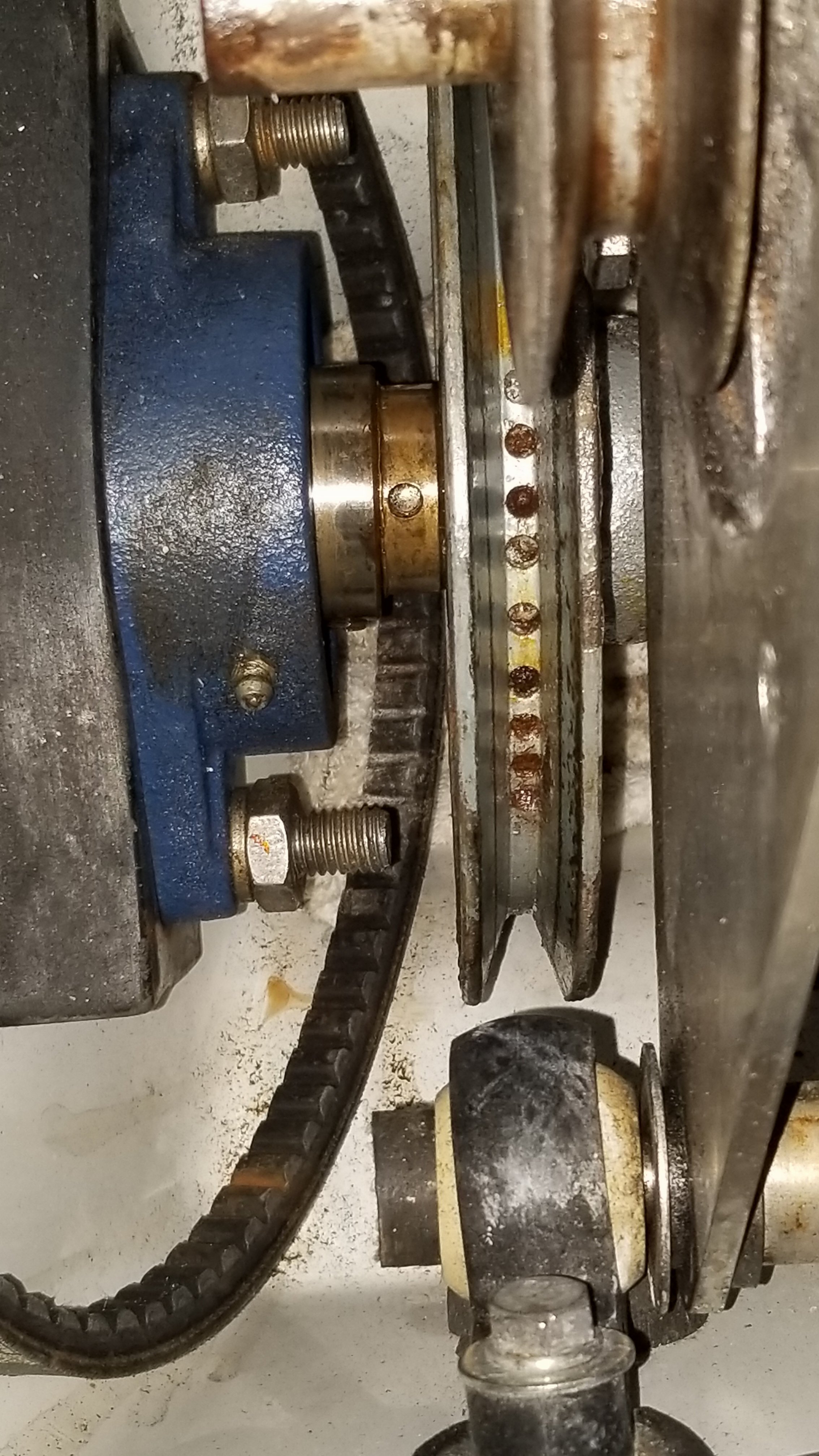

    Looking for instruction on how to pull back prop shaft to replace belt. Some pics of what I have:
    How does the shaft disconnect from the bearing box? Loon set screws on brass bushing and stainless collar?
    Not sure why there are a series holes drilled down in the groove of the lower pulley, maybe someone did it to balance it? I've got the added fun of having most set screws stripped out by previous owner/mechanic. It appears the brass bushing has a extra hole where someone drilled out a set screw and then tapped another hole.
    Thanks for any advice
  17. rtrafford
    rtrafford Senior Member
    Jul 13, 2019
    1,991
    Vero Beach
    Best guess is that the recesses in the shaft are the original locations for the set screws from the locking collar. That collar is what is holding the shaft into place, riding on the blue bearing. Remove those set screws, and it should all slide back far enough to clear the belt. Curious as to the adjustment for the locking collar location. Wonder if that bearing is a replacement that tweaked the dimension a fraction? When you get the collar loose, perhaps nudge the shaft aft just enough to get these holes into approximate location, then look to see what's happening around the prop? Might be able to return the shaft to these spots, or you might learn that the setup at and around the bearing has been changed.
    If you must, drill out the old set screws, then retap the collar for new set screws to replace the old stripped ones. Likely overtightened and stripped doe to not having these original holes to seat in...

    ...angle of the camera, perhaps, but is your pulley alignment proper? That same collar area appears to define the location of the pulley, so it's somewhat critical to get that right going forward...

    Don’t quote me on this, but I believe you remove the entire bearing assembly to slide the shaft back and then slip on the new belt.
    While you are at it, turn the bearing assembly 180 degrees to access the grease nipple, then when back together, grease it up good: The bearing is a thrust bearing, it pushes the boat forward, year after year, it needs good lube,
  20. Capt Ralph
    14,585
    Looks like the Zerk is up, just hidden above the port mounting bolt.
    I agree with Norse. Unbolting the bearing from the frame looks like a better idea.
