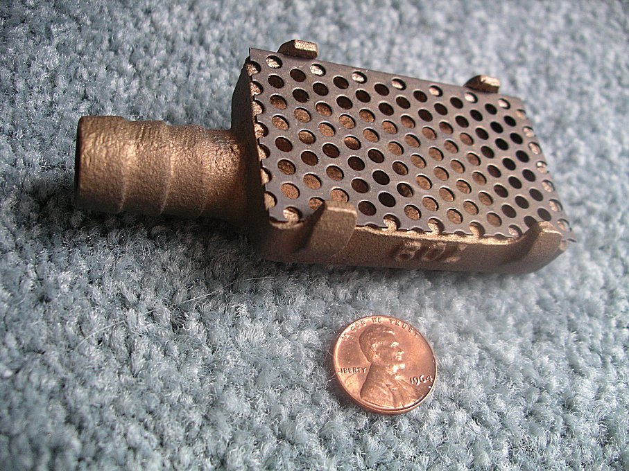

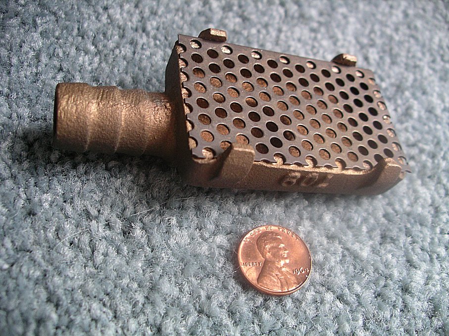

    Perko low water pick ups for a build your own set up.

    yes, I have dry bilge sys in a couple of locations, working well. Bad thing about the Perko is the inevitable back flow of water that doesn't make the lift. It'll get you close, but never dry.
  19. Capt Ralph
    14,575
    I remember (kind of) a low water pick up with your issue. A small inline check valve was inserted rite at the pick up. If your using 1/2" tubing, look at Whale in line valve part number FV1227.
    Very low, low pressure (suction) required to over come the spring, no back leak...
