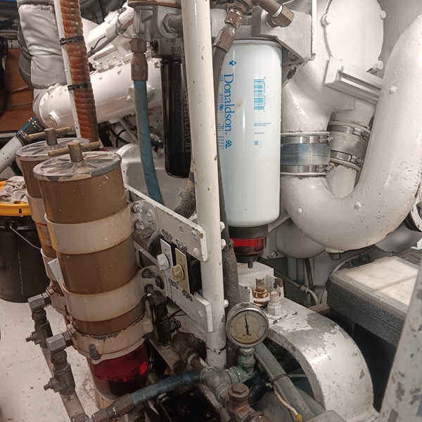

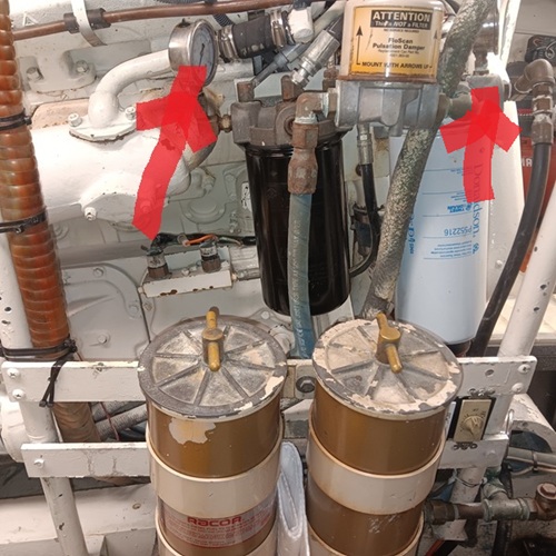

    Please check the blower bypass hoses and install a pressure gauge on the last filter output rite before the engine.

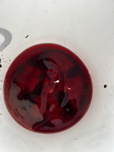

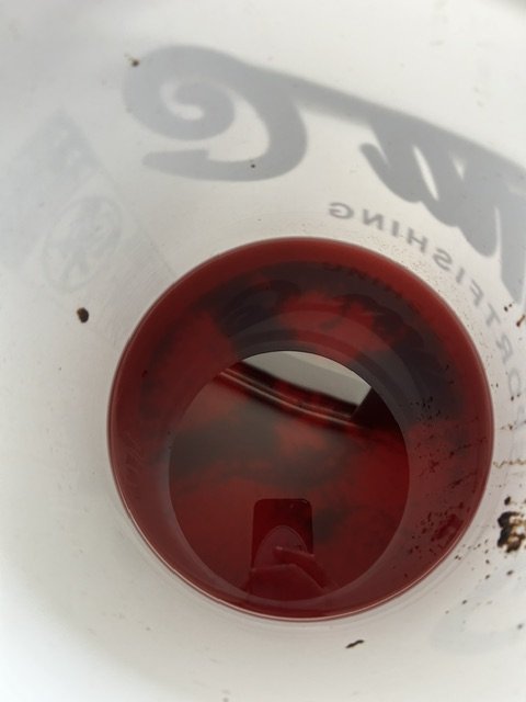

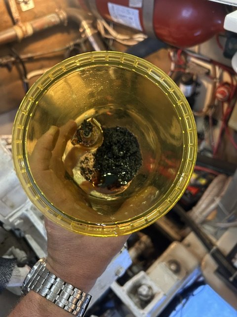

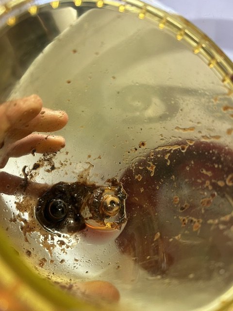

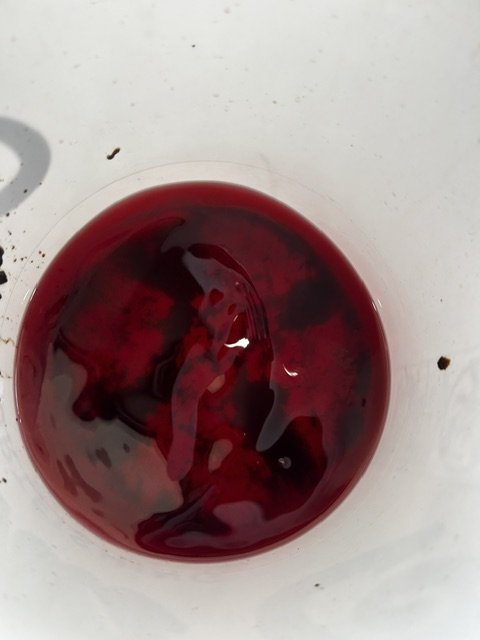

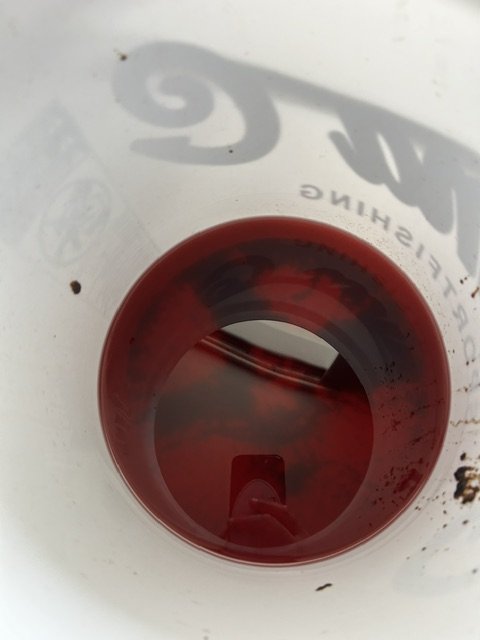

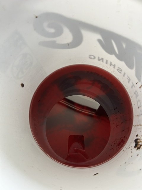

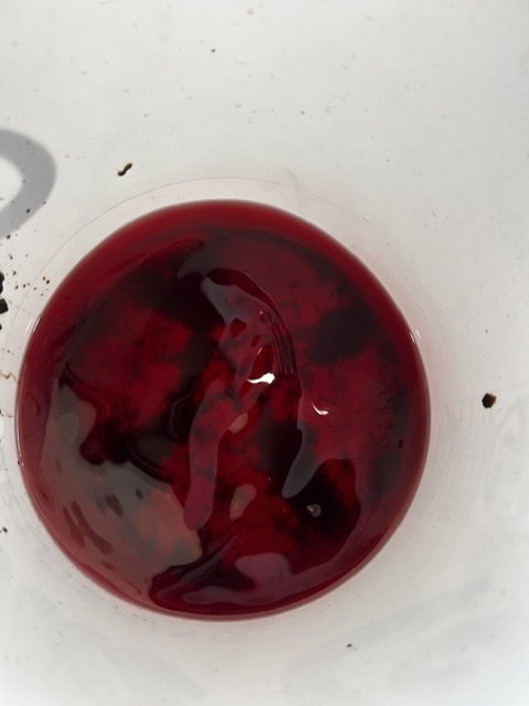

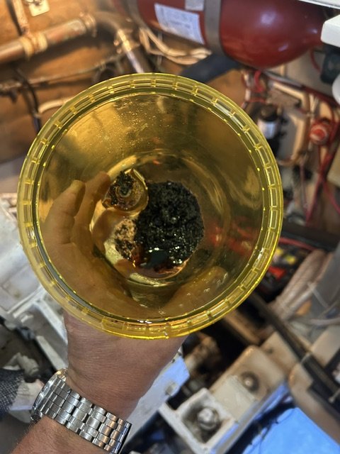

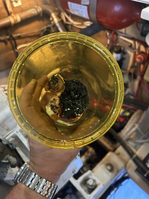

    UPDATE! Went to boat last night and noted that there was quite a bit of black , slimy, algae looking sediment in the bowls on both Racors. The life span on these being changed is unsure so I am starting from scratch on that end. I am quite certain that this is bad enough to be the problem. I am sharing pictures as soon as I can upload them.

  4. bradlangdon
    bradlangdon New Member
    Jul 12, 2025
    48
    510 SW South Carolina Drive, Stuart
    Carl, just sent those pics to you so you can upload them. Thank you.
  5. YachtForums
    20,951
    Here you go...
  6. Capt Ralph
    14,574
    That's not to bad but a great start.
    Send a pic of the media (filter).

  7. bradlangdon
    Jul 12, 2025
    48
    Capt Ralph, that was after whiping them out pretty good. the bottom of the bucket had alot in there. I am hoping that was it and I am sea trialing tonight.

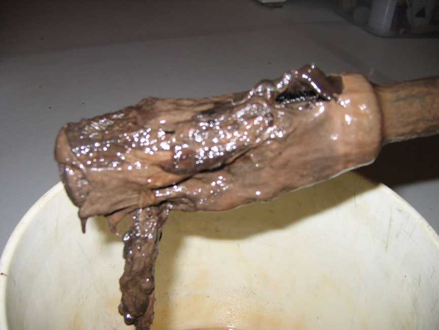

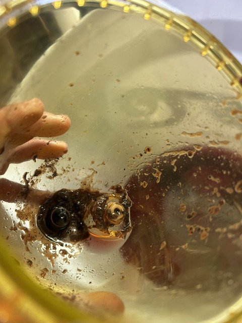

    13 years ago I learned about snake oils. This is my aft fuel tank pick-up after my first use of these products.
    If you have a dirty tank, get it cleaned and fuel polished by a real shop.

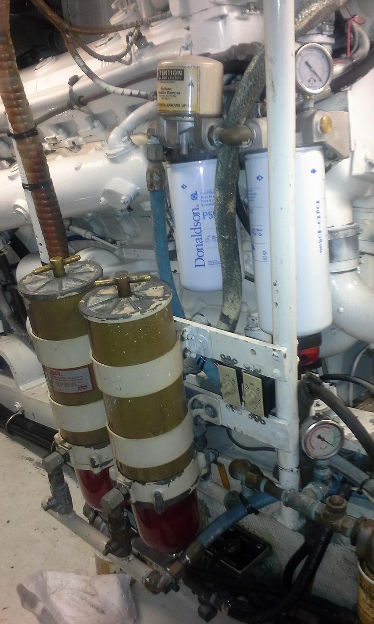

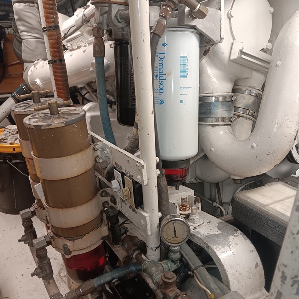

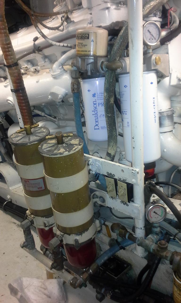

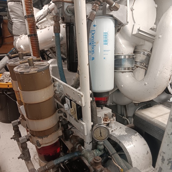

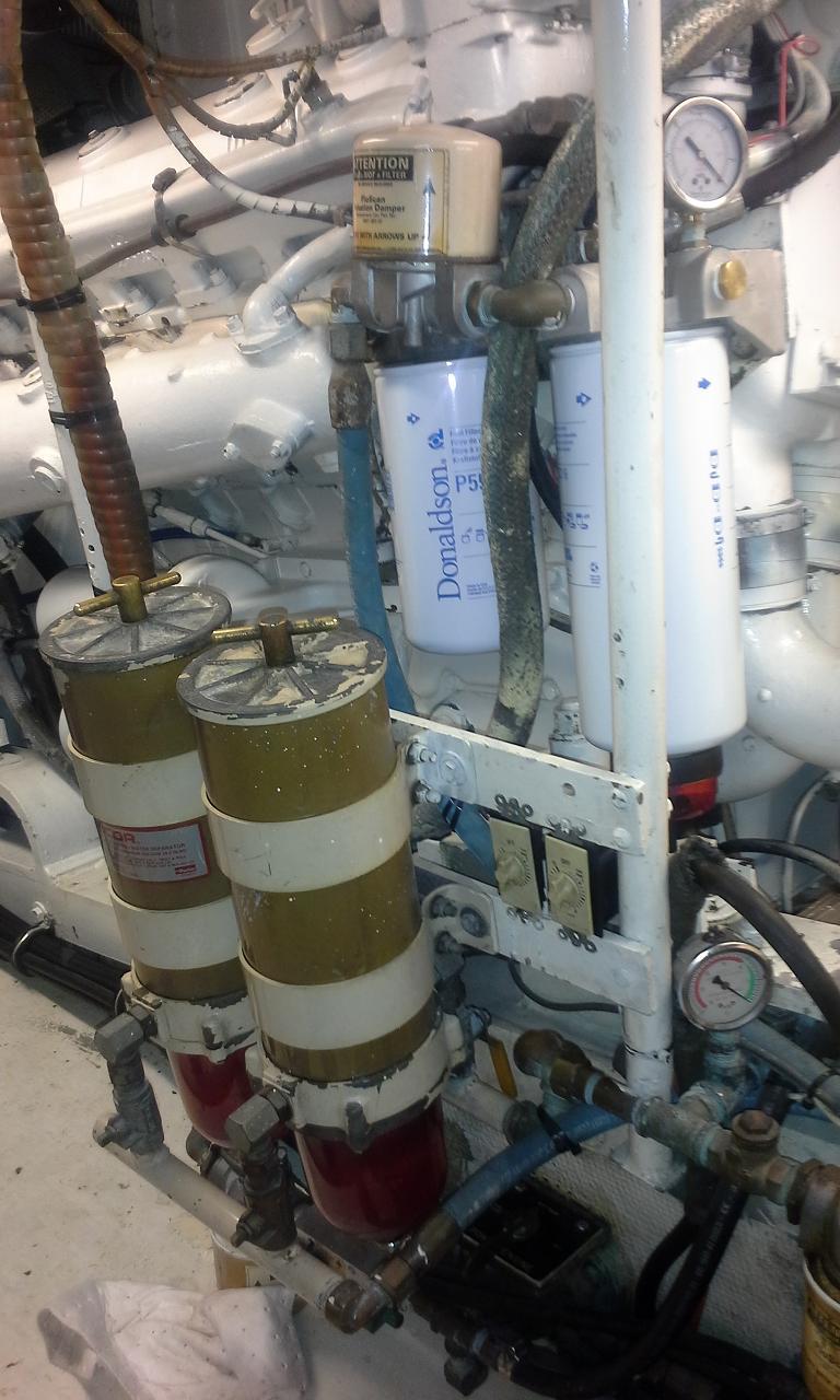

    On my 12V71TIs, Detroit spec'd 30 mic and 16 mic. Always ran great.

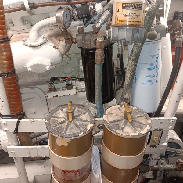

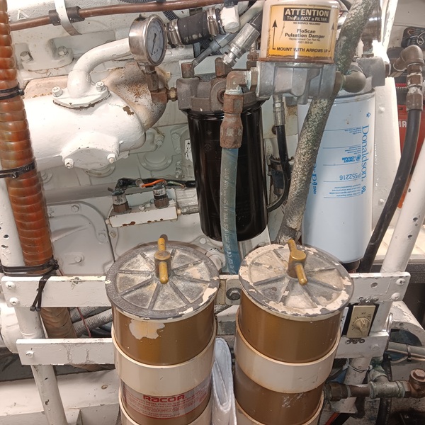

    I added a middle filter that was between 17 & 20 mic with a water bowl also.
    Funny that that second water bowl was collecting water (Racor stopped using real fish oil).
    Still ran great.
    Then like a Stuff For Brains, I installed 4-5 mic (black filter) as a final secondary. Lost 300 RPM off the top.
    Going back to the factory 16 mic this weekend.
    Why I bring all this up? I think your secondary is rated around 20 mic.
    Your cannon bore injectors are going to starve during your cleaning process running 10 mic primary filters.

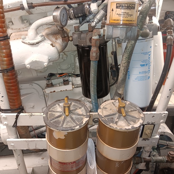

    Ok so, here is where we are. I have this exact situation, WOT under load is exactly same with both engines @2050 RPM WOT under load under way, at dock "no load" is reaching 2600 + on both engines. Both engines have normal temps, oil pressures, gear pressures, gear temps, all normal with one exception. I have changed the primaries and secondaries already. There is zero black smoke while underway operating normally . It simply will not turn up. If you fire wall it at idle in forward gear it will smoke for no more than two seconds and it clears right up and then hits 2050 and stops, both engines act identical. I ran the boat two weekends ago and noted that the aft tank dropped to 5/8 load and the forward tank essentially did not move on the gauge. I was under the impression that the aft tank feeds the starboard engine and the forward tank feeds the generator and the port engine. I also was under the assumption that the aft tank will gravity feed the forward tank so that the forward tank would essentially stay full until the levels equal out somewhat???? Given that I have zero black smoke unless I really , unusually, hammer down on the throttles - I assume that my RPM issue at WOT under load is a fuel restriction of some sort. I am wondering if there is a restriction on that aft tank, would that cause both engines to perform under WOT norms since the aft tank essentially gravity feeds the forward tank thus causing a total system restriction?? Does anyone have an owners manual for a 1989 Post Yachts 43 Convertible with 671TIB's? I could really use some help from all of you awesome Post people. I am pretty experienced in diesels but this one is stumping me and it is probably me not seeing the trees for the forest. LOL
  19. Capt Ralph
    14,574

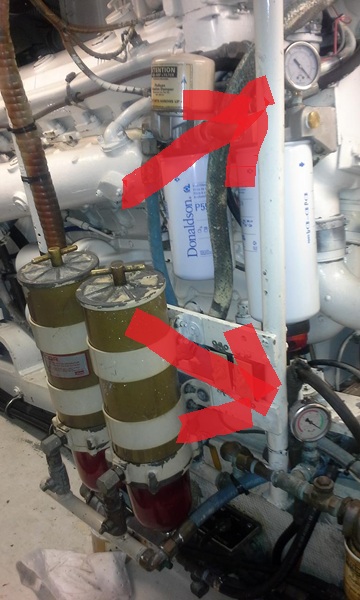

    Then you have vacuum and pressure gauges ready to be installed.
    Without them we are all just guessing.
