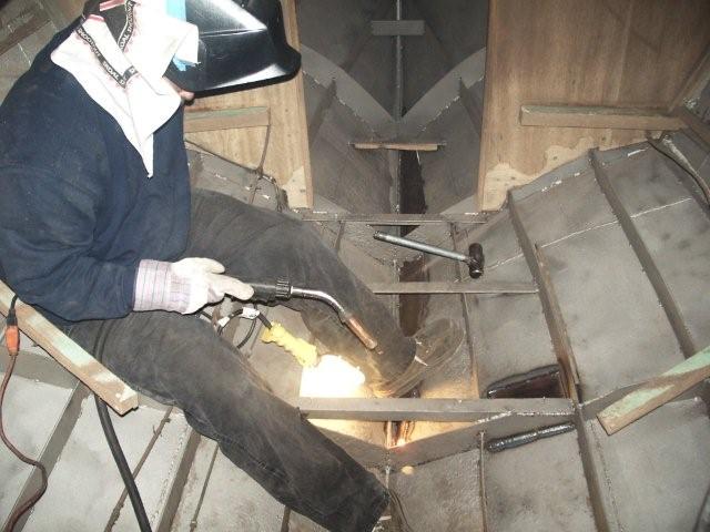

    hi check my pic how we did it

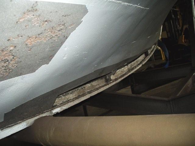

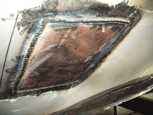

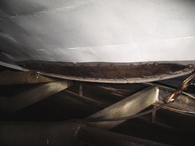

    Wow Erik .. thats an amazing tranformation, i am hoping my boat is going to come together as good as yours. Here’s the update, I had all the bad sections removed then welded new 3/16 steel inside and out. I then tested the welded sections with penitrent dye to verify no pinholes.

    Welding
    Ok yes it does look good. We welded with mig-welding inside and then stick with conventional welding outside.then polished welds, but we wore them on the outside pin hole, you can always weld again

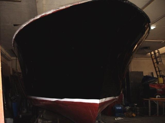

    Ice Breaker Update

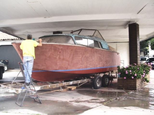

    I completed my epoxy primer coating, my anti fouling coats and inside hull epoxy coating. I am doing all my wood restoration, wiring and fiberglass repair before my final topcoat. I took a break for few months now I am back to work hoping to sea trial by the New Year.

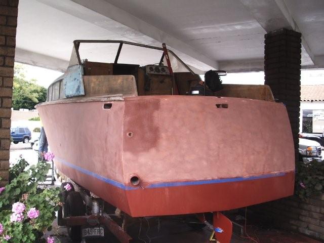

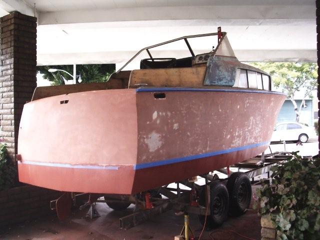

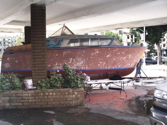

    I lifted the boat using five 20 ton jacks, I would secure the trailer to the ground on the port & starboard side, then lifted the front of the trailer about 10” from level than slide multiple 4”x6” blocks under the keel, then lower front jack which gives me access to front section except small piece of keel. Next I installed to two more jacks on the rear on each side, from the all ready supported trailer beam to a 4X6 that would rest flat along strong area under the boat, this would allow me to raise the boat -/+ 10” as needed. From their I would removed the bunk boards and moved jack around as I was completing all my coats, I was told the marine industry calls it bumping . NOTE: I always used doubled up jack stands as back up whenever anyone was working under. I only had one more picture before it went in the paint booth for prep. If everything goes as planned I will have completed bottom and topcoat pictures next week. Thanks for your support

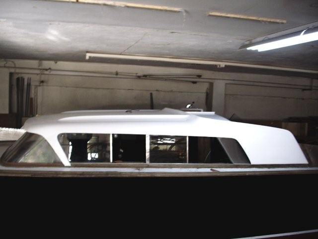

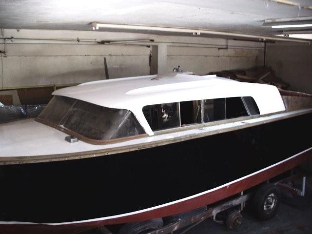

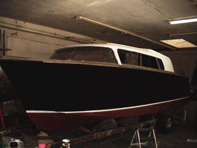

    Sorry these took so long I have been working on the cabin, I didn’t realize I missed so much action here. As you can see with my color scheme this is not my grandfather’s Chris Craft, although I think he would of still enjoyed it. I went back and forth on the colors between original and modern and my wife and I are very happy with these final results.
