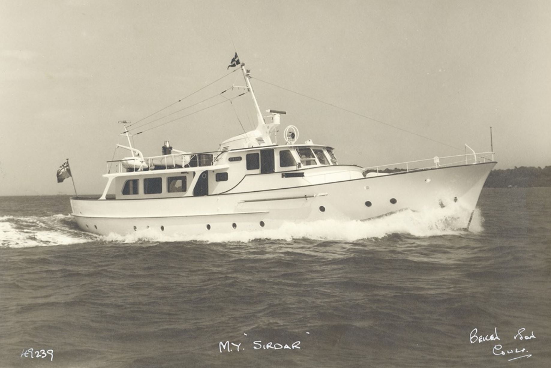

    I am replacing the dry exhausts on my twin mirrored pair of Gardner 6L3B's on my 1965 G. De Vries Lentsch Jr built TSDMY. As part of this I am exploring the possibility of including a catalyst or some kind of particulate filter (DPF) into the new arrangement which also includes restoration of the funnel and mast back to its original 1965 incarnation (as per the pic). The engines will thus exhaust at a reasonably low air-draft height through a funnel which sits atop the original boat deck (as per the pic). The boat deck these days is used much more for general entertainment and therefore I seek to keep it as free as possible from smoke, particulates and noxious gases. Obviously I understand that back pressures can't be compromised. I'm most interested in whether anyone has done this before and if so, what was your approach? Please no-one try and talk me into a wet exhaust conversion. With regards to the Gensets they are a pair of new Cummins Onan MDKR17.5KVA Quietline Series again being directed dry up the stack and on to the boat deck. So X4 chimneys in all.

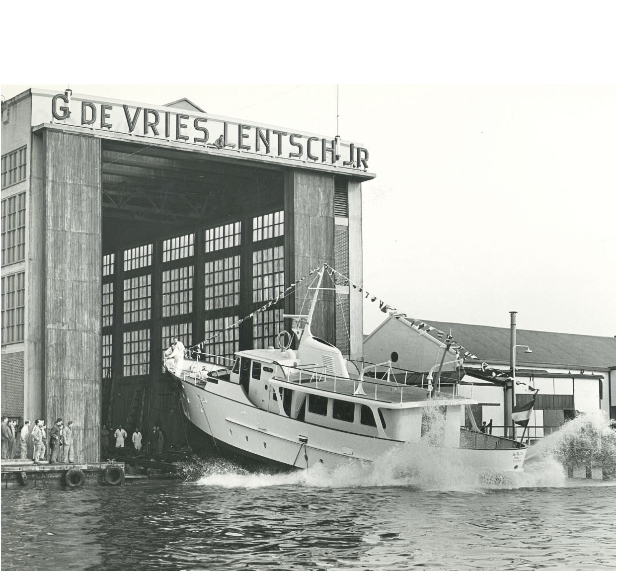

    Thanks. The canoe stern definitely has a positive impact in a following sea. She is a 1965 “Deep Ocean Class” long range motoryacht built by G. De Vries Lentsch Jr in Amsterdam. The build was commissioned by a New Zealand industrialist who sailed her round the world direct from the yard when the build was done. G. De Vries Lentsch Jr was the “by Royal Appointment Yard” who built the yachts for the Dutch Royal Family. Starting in 1840 it was the oil crisis of the early 1970’s that eventually saw their demise after building nearly 3000 custom craft. I am only the fourth owner of MY Sirdar and I have undertaken a total refit from the keel bar up. I hope to launch within a few months but will take longer if I need to in order to achieve exacting quality on every aspect.
