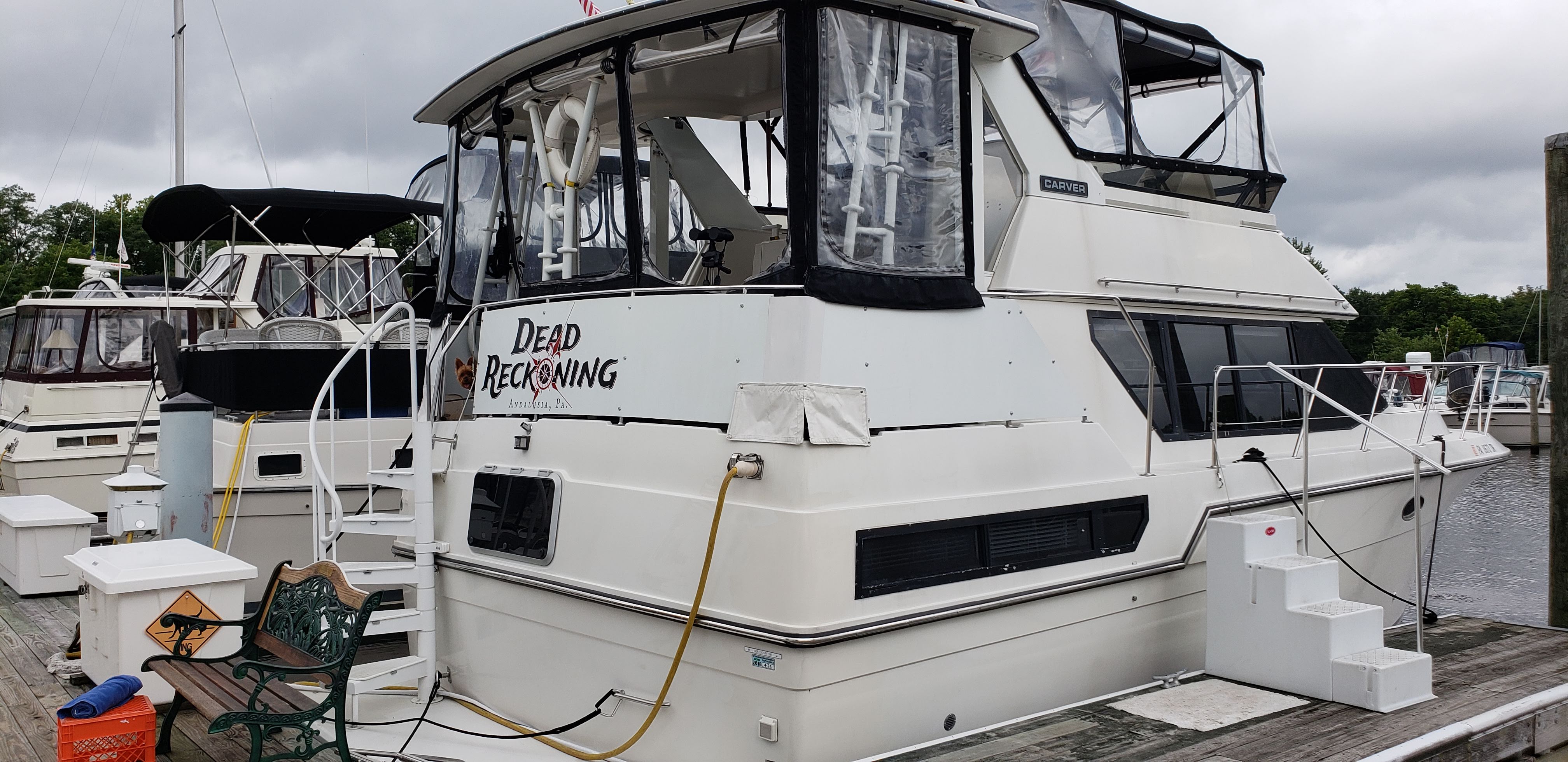

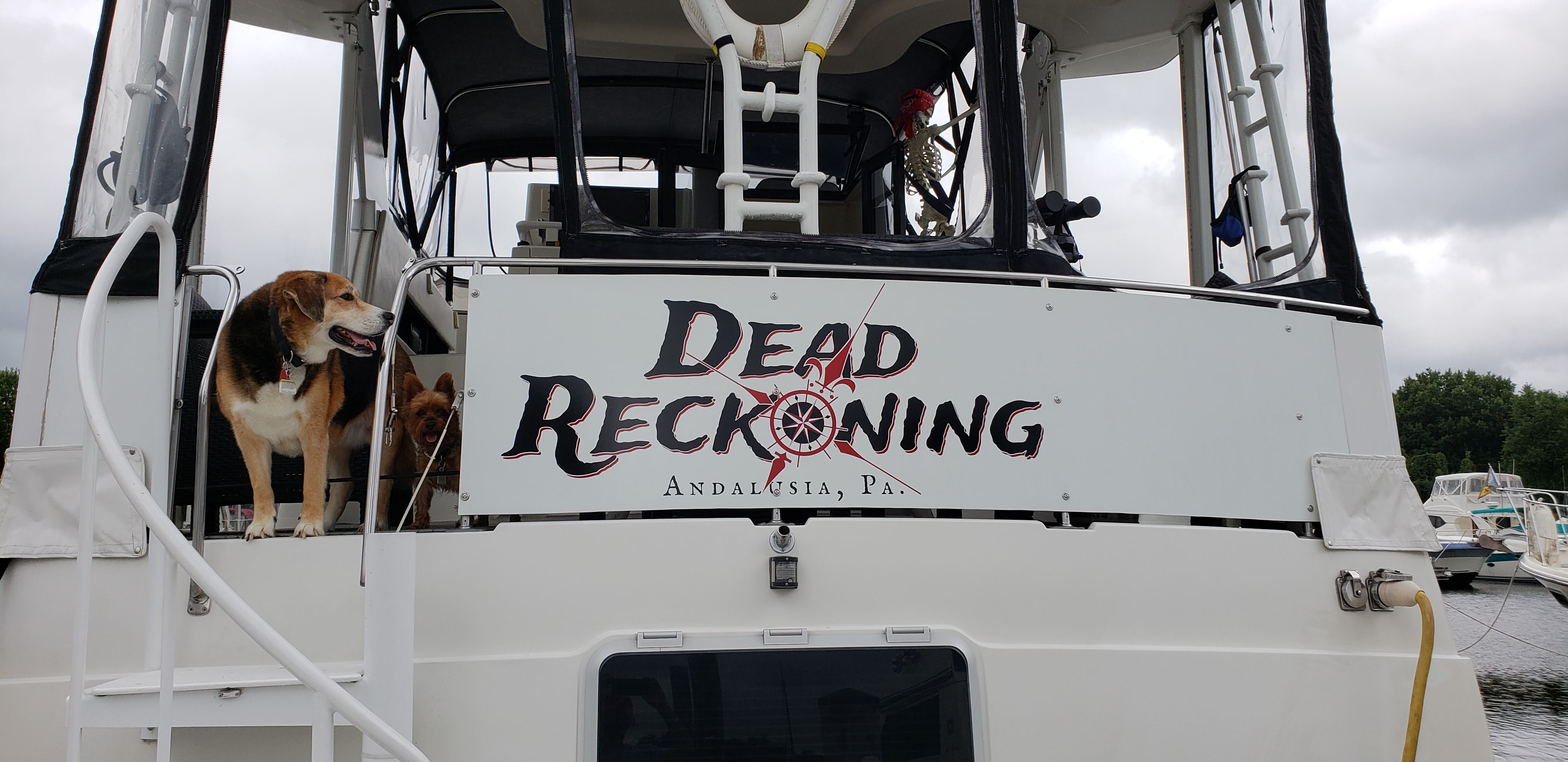

    That picture you posted is now my boat. ! Funny finding a picture of your own boat years before you bought her! She is no longer named attitude adjustment though. We performed the Renaming ceramony and named her DEAD RECKONING. She is a great ship! She was well cared for by her original owner. The spinal steps are great. They were what originally caught my eye when I was shopping for an aftcabin. The only complaint I have is that it is difficult carrying boxes or supplies aboard because of the railings. It makes it a very narrow opening so you need an assist to help you carry things above the railings. Or just bring supplies in from the side entrance. But... wow, I was really surprised to stumble on these pictures. Once I saw the Name in the second pic I knew for sure it was my boat. Really great! She is being g well cared for. If you are the original owner, I can send ya pics if ya want. I posted a couple already. Here is a couple...

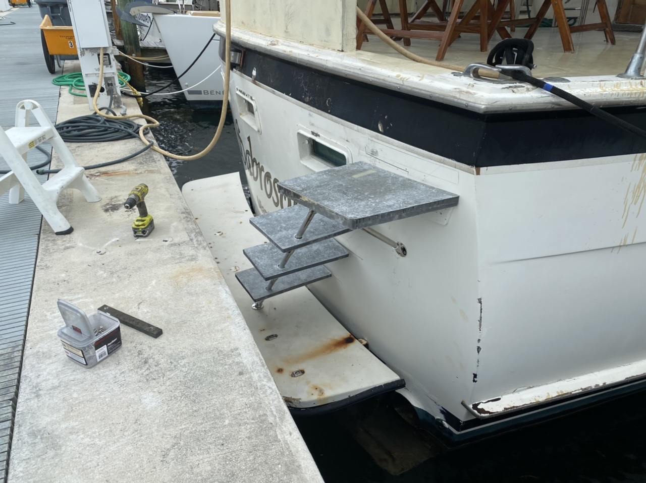

    BBDED3AE-EEA4-4004-9FE9-7D6A3B4B67C4.jpeg Here is what I did on my 53 Hatteras. These pictures are a months old, it been faired level and non skidded since. Pretty simple. To top platform is made of glassed 2” coosa. Secured to the transom on top of strip of starboard with a 45 deg angled 1” tube. From there I have another 45degree angle tube going down to platform. Again each step is supported by a strip of starboard. The edge of the steps are epoxied to the transom
    the tube goes theu each step with a SS rail fitting. I also used a shirt piece of tube going into a tee to support the edges of each steps which are made out of glasses 3/4 coosa Very simple geometry and very solid.
    as a bonus I no longer have to use boarding stairs on the side finger pier because I always a step at pier level

    With a rail that'll work nicely. On the 37' Carver I used to run they had a spiral stair, took up about 3' of the swim platform with a couple of inches to move around it if needed. Real convenient.

    I added a grab rail on the transom just about the toe rail. Works well. Not adding a rail outside the steps
  8. NYCAP123
    11,209
    Sounds like someone could walk the plank but I'm sure you know what you're doing.

    I still have to finish building the weather board out of coosa on the starboard side, and will have a gate closing protecting access to the stairs

    Will be interested to see when it's done. My concern with the lack of a railing is that if someone is exiting via the transom with hands full, a pet or just their head in the clouds, they might step off that top step and have a 4' fall.

    I set the top step lower than the deck making it steeper than normal. That prevents anyone from going to fast. You have to step on it sideways.
