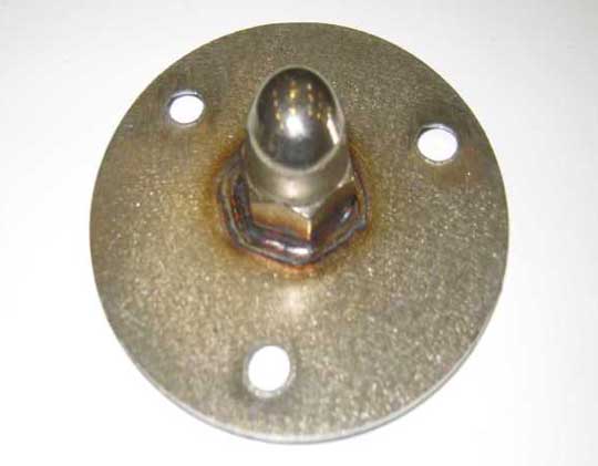

    Hmm. UMT finally sent me a picture (attached) of the underside of the part that goes into the deck. I'm not sure whether I should be impressed or not. Certainly it looks pretty ordinary on the underside (ie: not "heavy duty").
    They way they are approaching it, each of those holes carries a screw that supports about 42 lbs of weight (assuming a 1000lb dinghy/engine/fuel/chocks).

    First off- resize the photo's so they fit in the screen. Many liferafts and dingys are attached with screws not thru bolted. I had the liferaft on the bow for many many years with screws and no issues. UMT is a AFAIK a reputable company- do you think they are cutting corners with the screws? Ask around and I think you'll find it's standard/acceptable to do what they are doing and you should have no problems if installed properly. BTW- I've had tef-gel on outside dis-similar metals with zero corrosion/galling after 6 years, and I'm not the only one who knows about this "magic snake oil". You make the call on the gel- listen to someone who doesn't use it and then dismisses it as snake oil, or someone who does and the results are proven.

    The fitting looks fine, but over the years I have witnessed many fittings that were screwed down being ripped out. I highly recommend that it is through bolted with a large backing plate and some thought as to how to deal with core material compression. Several options there, delron blocks, dig out as much core material as possible and flood with epoxy resin the list goes on.

    I agree about their good reputation amongst S. Floridians I've asked. Actually, the thought about cutting corners came from them. They said words to the effect of "Yes, we can do it the way you suggested (scrape and fill a larger area of core), but of the hundreds we do each year, only 1 or 2 are done in any manner other than just straight screw down with 5200. If there were problems with that technique, we'd have known by now. Our way involves much less labor, is much cheaper, and it works."
    But, this advice contradicts information I've read in Steve D'Antonio's and David Pascoe's articles about attaching things to cored surfaces, and in various articles (example: here and here), and clearly contradicts the advice of several posters here.

    In this case, the installer says that the screws themselves will grip both the upper and lower skins. I can see this being true if the threads don't strip. Clearly not as thorough as having a spacer to prevent crushing, or having solid resin to prevent crushing.
    Part of my problem is that while I'm hearing a lot of opinions about how this approach might cause problems, neither here nor on T&T am I hearing about people who have actually had a screw down approach for dinghy cradles over nidacore, and who have suffered as a result. My hesitation is really caused by the super-good reputation of the installer (UMT). I mean, heck, if you can't trust someone with a good reputation, who can you trust!
    Also, and in response to a prior comment, I believe (and am checking) that my dinghy's tie downs will (if I go with this installer) attach to the cradles themselves, not to the boat deck (as you can see in the pics, there are large rings on the cradles for this purpose). Therefore, there will not be a large tensile load on the boat deck. The boat deck loading will be caused by weight and inertia as the boat moves, but not by the pull of tie-downs.

    I would never through-bolt a core without reinforcement ... you will finish uo flexing the skins and crushing the core.
    Nor would I ever embed metallic sleeves.
    Perhaps you might like to consider this approach
    1 .. drill your bolt holes directly through both skins and core
    2 .. bend the tip of a small nail (several mm larger than the bolt) to act as a router, attach it to a small battery drill, angle it into each bolt hole and clean out the core... then carefully vacuum out the core holes ... make certain you get all the loose material out of the holes
    3 .. masking off the under skin holes with masking tape
    4 .. mix your epoxy and very carefully work it into the holes from the top side avoiding any air pockets.
    5 .. after the epoxy has set hard, sand off any expansion excess
    6 .. redrill the core and through bolt the fitting using whatever 'sticky stuff' you favour for waterproofing
    Have a beer (or two) because now you have joined the high-tec composite team
    hope this helps

    Just to report back to the group that the approach ultimately taken was essentially that reported above by hamall9. Holes were drilled, Nidacore was removed using an angled tool, the hole was filled, left to harden, and then drilled as a solid.
