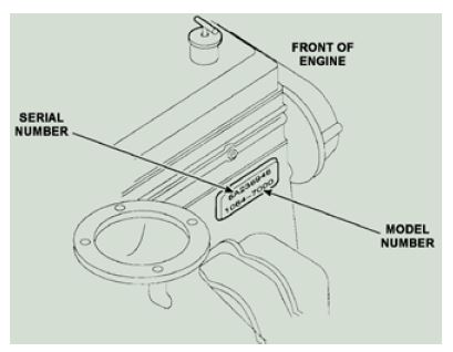

    The serial can be found on the exhaust side, at the front top of the block.

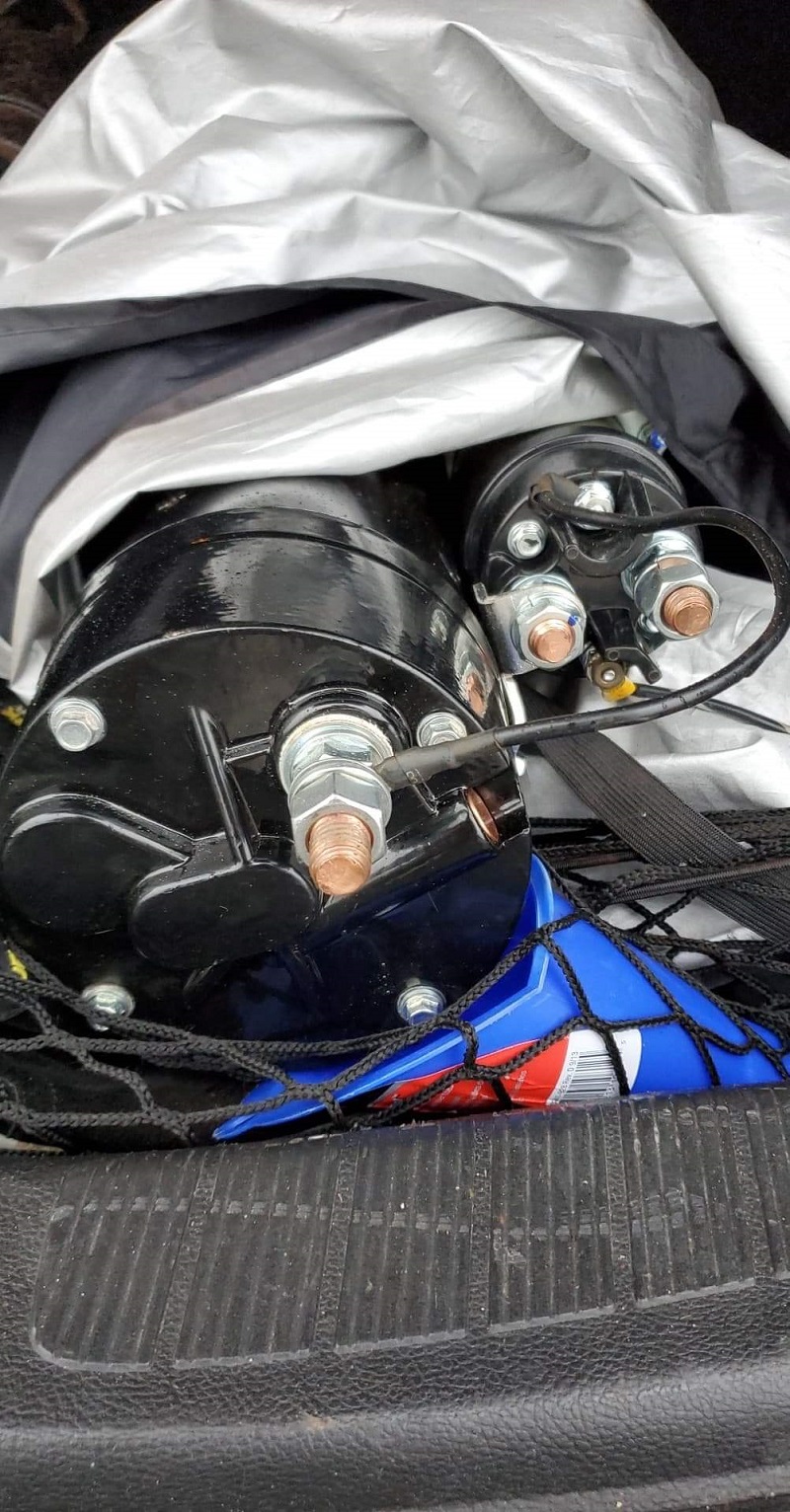

    New starter solenoid will not work for some reason.
    Old one starts right up but solenoid is still crap on it. Part number 09085843
  11. Capt Ralph
    14,574
    Send some pics.
    Most big starters and solenoids are ground isolated and need their own Battery-Negative straps.

    Got your pictures. One was just the side of the engine. The second pic does show you have an isolated ground starter.
    Get me a few more pics of all the contacts on the solenoid and I'll draw up a schematic.
    Don't just start clamping wires on, lets take our time and try to get it correct the first (couple) of tries..:rolleyes::rolleyes:
    Lets also try to find that model & serial number. Need to ensure the starter spins in the correct direction.

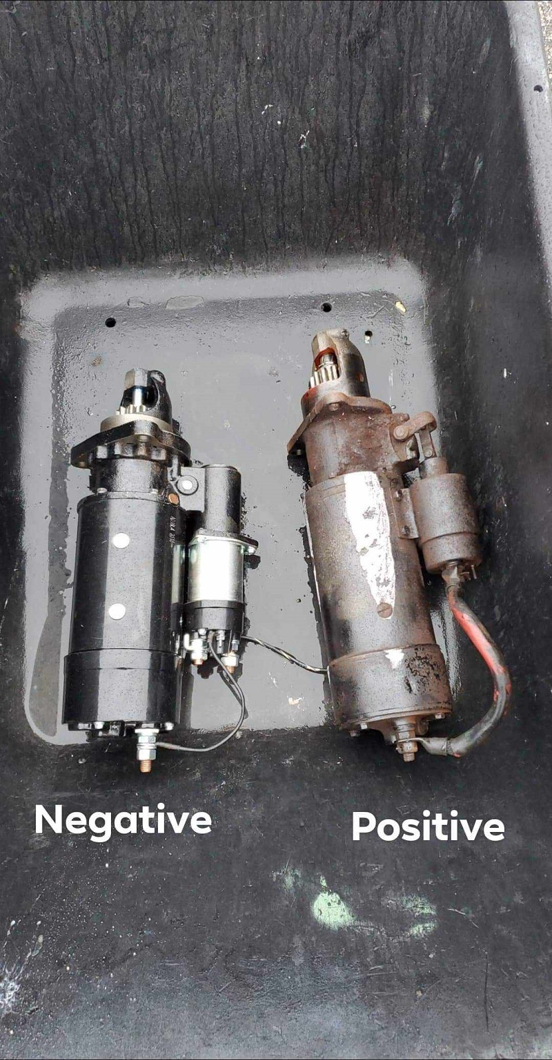

    On the new part I was told specifically that nub on the end was different then the original part and they made the new part have negative on the end of the starter instead of positive.
  17. Capt Ralph
    14,574
    That stud in the pic should be battery negative.
    I need to see the solenoid to figure the connects to it.

    Yep, The later starter motor.
    The negative battery strap goes on that post on the back of the starter. The positive strap goes to the top post on the solenoid.
    Wire with yellow strips is your engage wire, to the starter switch, starter button or in-term solenoid's out-put post.
    I think you may have to ad a second negative strap from the starter (B-) to the block if the block has been used for a common negative path for senders and grounds to other options.
    Next concern, It may just be the angle of the camera, Are the starter noises the same length? The older starter looks like it may have a longer reach inside the bell housing, Typical of a Allison wet flywheel.

    Newer one works.
    Flywheel moves so motor is not seized.
    No rebuild on old Solenoid as they can't find parts.
