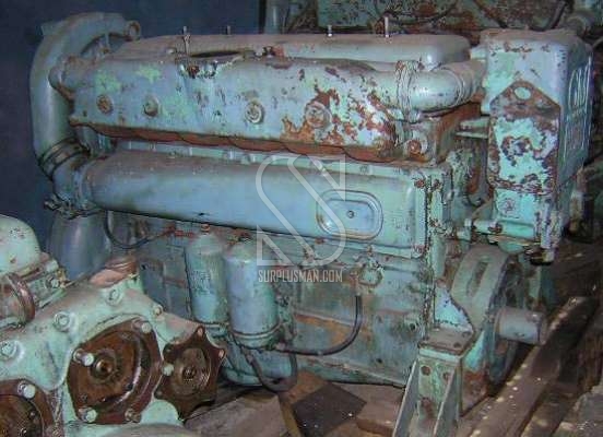

    You got me on that one, I do not believe I have ever seen anything in the 110 series or if I did I must have assumed it was 149 or 92.
    But I have seen a 3-53 and a 1-53

    Remember the old 50-series two cylinder gen-sets also?
