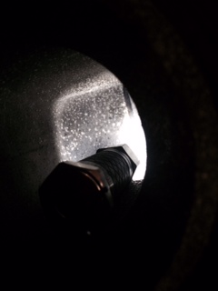

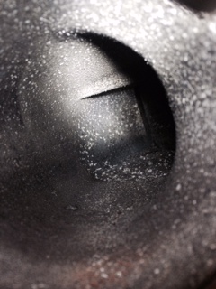

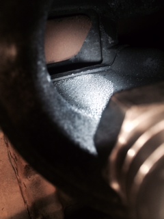

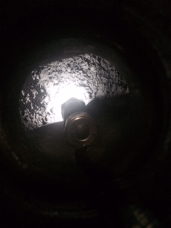

    Loss of Power Found!
    Hi Guys,
    Sorry for the Long Delay, I was tied up with family summer vacations and work.
    Anyways, after checking all the fuel supplies, pressure etc. I decide to open up the airboxes. The Outside inside bank box was pristine however the outside bank box(The box that supplies air to the outside 6 cylinders) was 90% clogged!!!
    I washed it down a few times already, but every time I come back I see salt residue.
    I ran the engine with the turbo connected to it, and I don't see any water coming out. I ran as high as 2000 rpms. I just cant seem to wash all the salt off.
    What do you guys recommend to get all the salt off?
    Also a few aluminum fins at the right edge of the box have eroded away due to the salt. At this point we can say it has been there since my April 30th trip to the Bahamas. It was on this trip that I had two clamps break off and salt water squirted everywhere.
    Im thinking of taking the box out and dipping in some solution and blowing it out with a compressor hose. What do you guys recommend? Also might have it pressure tested.
    Also, how much salt do you think the engine injested and other than an oil change what else can I do to get rid of the Salt?
    Thanks Again and Sorry for the Delay.

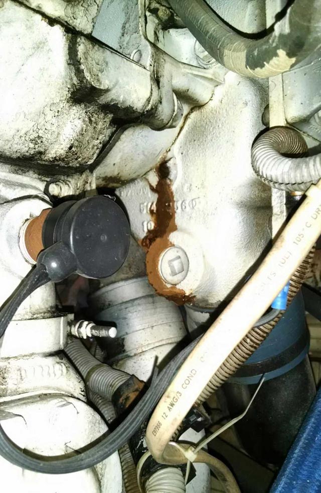

    Detroit Diesel 12V71 Water Pump Leaking
    I recently started to see water underneath my starboard engine. It looked like rusty water from the radiator but I wasn't sure. I check expansion tank and it was full.
    I went out a few weekends ago and as soon as I got up to 800 rpms coming out of the marina, my high temp alarm went off. I brought it back to idle, ~640rpm, but temp kept going up. I returned back to the Marina and turned off engine. I verified with heat gun that thermostat was at 220 and intercooler was at 194. I waited 2 hours and opened up the expansion tank which was full to my surprise. Then I removed radiator cap from the heat exchanger and there was not water in there. Why didn't expansion tank fill the heat exchanger? Must be clogged. I then filled it with regular water only. I estimated about 2 gallons worth. Then started the engine and took boat for a spin and temps were back to normal.
    Do you think the overheat might have caused damaged? It was barely above Idle. Engine seems to be normal.
    While troubleshooting my other problem with this motor(Clogged aftercooler from Salt injestion), I notice the water leaking underneath the engine block. I finally traced the leak to the Engine water pump. Seem to be leaking through weap hole.
    Do I need a new pump or just Seals? I see there is a special tool for seal removal.
    Can someone elaborate on how difficult and how to change the water pump? Also do you recommend a complete cooling system cleaning and servicing of coolers?
    Thanks in advance.
  8. Capt Ralph
    14,552
    Back seal is leaking a bit. The seal is lust like a well pump seal. I replaced mine with what redneck tools I have (nothing special).
    If you're inclined, you can do it. No need to pull the whole pump, all you need to get at is under the front cover.

    The other tools I have pretty much also. But after I pop off the cover of the pump, do you have a step by step description of what to do?
    Just quoted a reman pump and its $538 with the core. Or a rebuild kit is $120.
    Do I have to rebuild the entire pump? Seems like I only need to replace the seal like you mention.
  15. Capt J
    14,892
    Honestly, I'd put a reman'ed pump on. Most of the time when the seal leaks it's for another reason. A bearing going bad causing impellor wobble, etc. You can try the seal, but it's only a fix 40% of the time. It's not very hard to change the seal, just pay attention to how it comes apart, or get a diagrahm from the DD dealer you buy the seal from.
