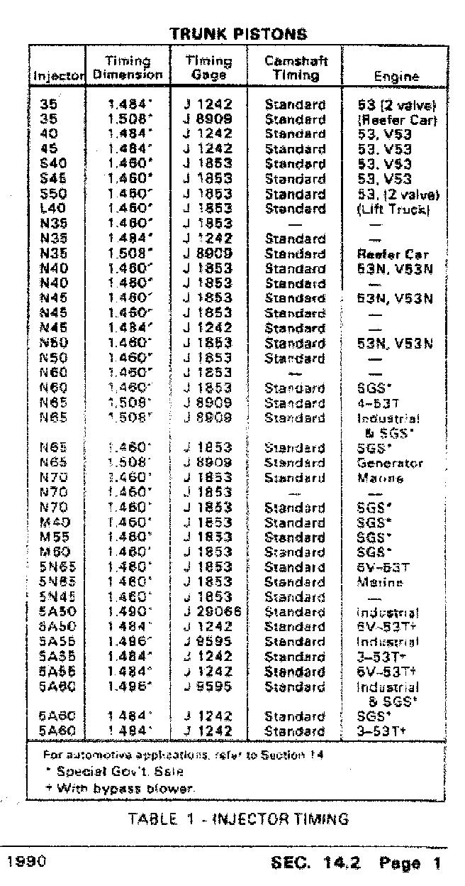

    List of factory injectors below.
  7. Capt Ralph

    Attached is a power curve and injector list for the 8V-53N, marine engine.
