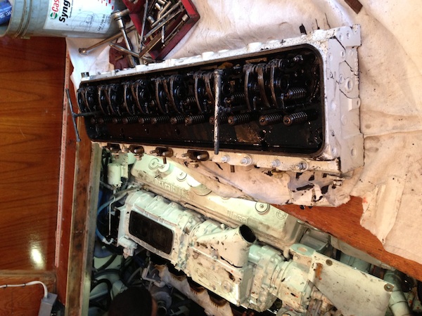

    Here is my 12V71TI cylinder head on its way to the shop for a failed "injector tube" ... yet another of the many ways these engines can fail.
    Fortunately, it looks like the work will be limited to re-sealing/replacing the injector tube and reinstalling the cylinder head.
    After the first two overhauls of this engine (in 200 hours) I learned how to quickly remove my salon couch, carpet and hatch cover for total access to the engines. Now it's been another 250 hours or so and the engine is coming apart again. Doesn't even phase me anymore. Just another day.

    I hope it's NOT the same shop doing the work. I would really question why are you having this problem if the motors were truly overhauled. Properly overhauled heads include new tubes that should last near forever.
    I am sorry that your having extra problems in less than 250 hours. But this is a strange failure that should of not happened after a proper major.
    Good luck, sleep well and dream of large women.
    ,Dread Pirate Ralph
  7. Capt J
    14,901
    Why did the injector tube start leaking? I find that to be strange if the motor was recently rebuilt. They should have been changed and usually they last near forever and you only have a problem once in a blue moon if you're removing injectors, they either get stuck in there or you have a problem when removing an injector.

    The Injector Tube life should be at least equal or greater than the hours accumulated between complete overhauls. If the tube failed in combustion, they most likely were not reamed properly, if it is a coollant failure, they most likely were not installed properly or the heads have started to fail.
    Has the condition of the head been checked/verified - any cracks that may lead to additional coolant type failures. Having rebuild issues at 200 hours (is tha right?) lead me to think that there are some outside circumstances going on - is your mechanic an independent or associated with a dealer/distributor? What is his track record / reputation?

    We'll see ... the engine was overhauled this last time by John Carey himself on the stand in his shop. New cylinder head castings were used. John checked all the tolerances and bored the cylinder bores. I'm confident that John will figure it out. At this point, it looks like there is no further damage to the engine.
    I have certainly had my share of bad luck with this engine.
    #1 .. $65,000 overhaul by Saunders Yachtworks of Orange Beach, AL ... Failed immediately. Saunders took no responsibility at all. They are the worst shop I have ever had the misfortune of patronizing. May bad karma forever haunt them.
    #2 .. Larry Kress of Central Marine, Herrington Harbour, MD took $25,000 to remove the engine from the boat and leave it in pieces. Went out of business. (7 months of heartache)
    #3 .. Complete overhaul on the stand by John Carey of Carey's Diesel, Leipsic, DE. $45,000. Took it from basket case to running in the boat in a month. Great guy ... nice business.
    Now the cylinder head failed. Hard to believe and I'm sure they're not happy about it either. I called Carey's on Monday ... they had the cylinder head off Tuesday and back in their shop. I think she'll be good to go in another week. I am confident Carey's Diesel knows what to do.

    What was the failure with the tube? Water leak? Blow-by? How was it detected? Who actually put that head together?

    Carey's built the head up from a new casting. I detected the leak because the Walker Air-Sep Drain Tank filled with coolant and started making a mess. I also noticed coolant overflow from the coolant cap on that engine.
    They have not yet determined what caused the failure of the injector tube. They may still determine something else is wrong ... cracked head etc. So far, though, it looks like leaking injector tube.

    It seems that the cylinder head casting (that was new) is bad. They cleaned up the head and installed a new injector tube in the #2 (that had failed) and the injector tube would not seat properly. It went down too far so they ordered a new cylinder head.
    New cylinder head should be here this week and they will install.
    Should be going again before long.
    Mike

    New head (cast) warranty? Seems they would of seen this event on first build if they were looking. Sorry your having more delays.

    New cylinder head installed ... all systems go ... sea trial went well. No leaks, fairly clean running. Good to go once more. Time to put the interior back together.

    I had one fail on a 12-71, #2 .seems some carbon manged to get up between the injector and the tube causing a split and then hydraulic lock, 12K later...DD did the work and reconditioned the head..if you are lucky and can see some carbon traces at the top of the tube then do the fix right away, we noticed one on the other engine and did the clean up right there, so every year I pull the rocker covers and do an exam to check for any carbon traces. Hopefully can find something prior to a failure.
