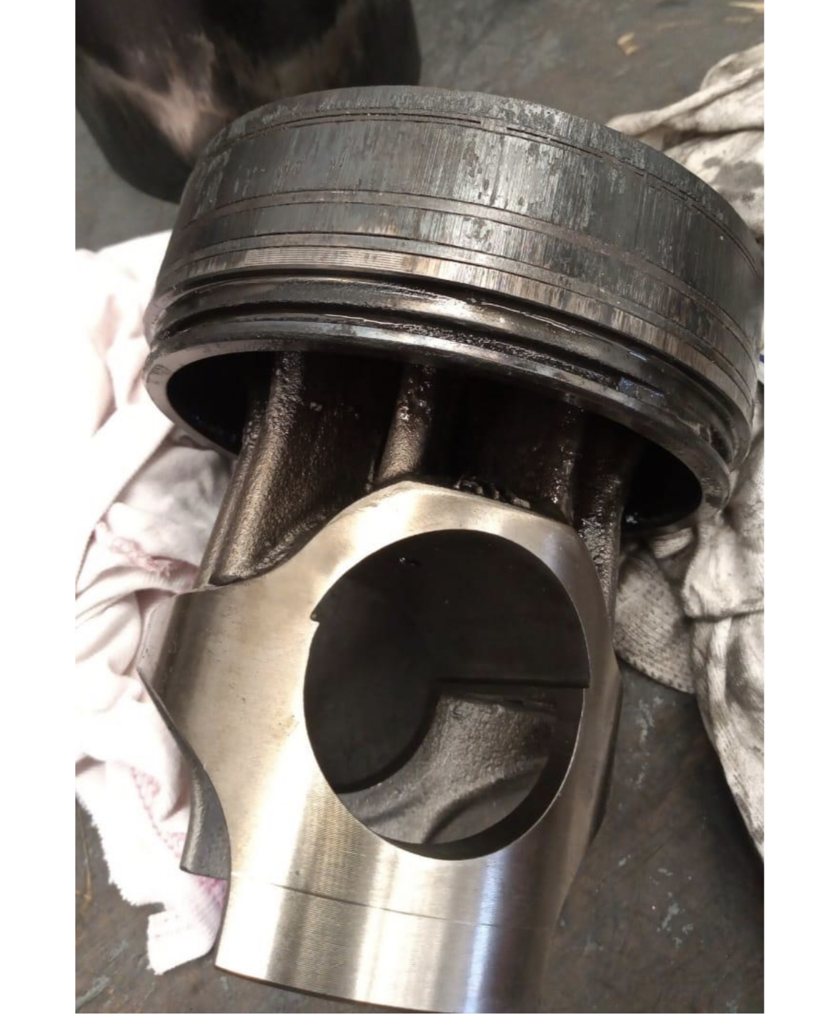

    I’ve got a 1998 SeaRay 480 SedanBridge with Detroit Diesel 6v92 engines.
    This engine is the higher horsepower with 15:1 compression pistons.
    I’m looking for a piston crown assembly. Apparently MTU is back ordered with no delivery date listed.
    The part number is: 23517665
    Any ideas? Salvage yards with engines being parted out? OEM? Right now I have a very expensive paperweight unless we can find that piston.
    TIA

    That’s the worst part, the liners were available so we bought (6) new liners. The plan was to reuse the piston/crowns but (1) was not usable. So they sell the liners but not the piston crowns. Go figure.

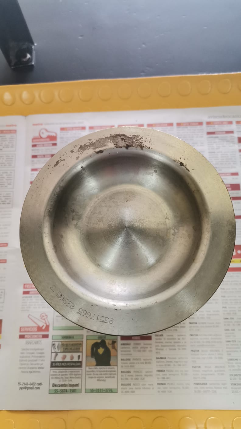

    The engine serial number is: 06VF218355
    The part number from MTU is: 23517665
    Piston 1 3/4
    It’s a 15:1 compression.
    The basic piston for the 6V92 is 1 1/2 and 17:1 compression, but the one we need is listed above.
    Thank you!

    The 15:1 piston was used on the 6V92 TIA. These have been recently been rebuilt by members on YF.

    We have called every major supplier that deals with Detroit and have spoken to MTU directly; this part has been on back order for over a year with no future production currently planned. What’s weird is they have the liners. ::sigh::
    No piston : no worky
    We are looking for someone who can rebuild this one, or maybe one out of a salvaged engine.
