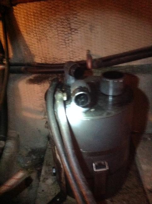

  13. Capt Ralph
    12,649
    It looks like a remote crank vent bottle. Old Racor (or like) stuff.
    Crankcase pressure and fumes would normally blow thru this and back into the air filter. Gelled oil would be reclaimed and deposed of.
    The other lines would be air box drains.
    Newer crank vents would return the oil. With air box slobber, you don't want this oil reused.
    Has anybody serviced these bottles (cans)? Drain or pour the oil out of them?
    The guy you had bypass it, probably directly connected the crank hose to the air inlet, it would then be consumed and then out the exhaust.
    Question;;;; Was the exhaust blue before this mod? Probably not.
    You have some crank case pressure issues.
