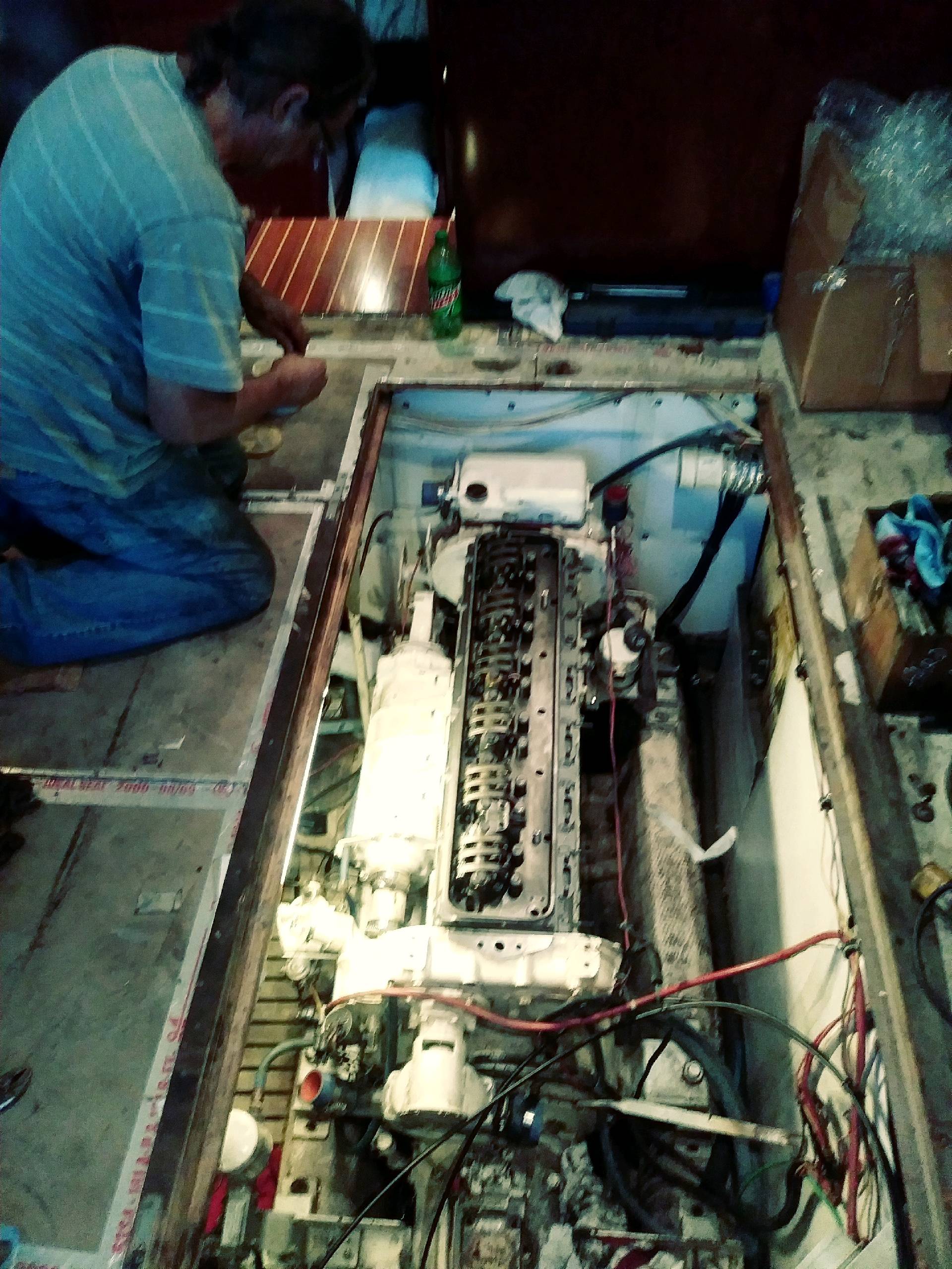

  17. Boomer
    Boomer Senior Member
    Oct 14, 2017
    677
    Seminole

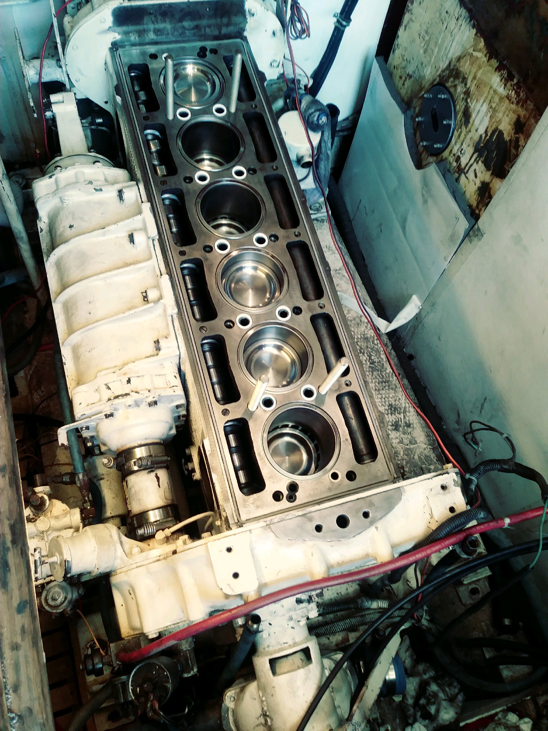

  18. Boomer
    Oct 14, 2017
    677
    Seminole
  19. cleanslate
    cleanslate Senior Member
    May 29, 2018
    1,661
    Cherry Hill, NJ
    Wow! Great news , is that you doing the work?
  20. Capt Ralph
    14,573
    Gad I miss working on straight 6s. That's what I started on when I was a kid.
    The bottom end of a 671 is a brute.
    I still don't think there is a crankshaft of any mfg that can take so much abuse and stay in fine shape. Sadly, The valves and pistons don't when the H P is poured on.
    Their still my fave.
