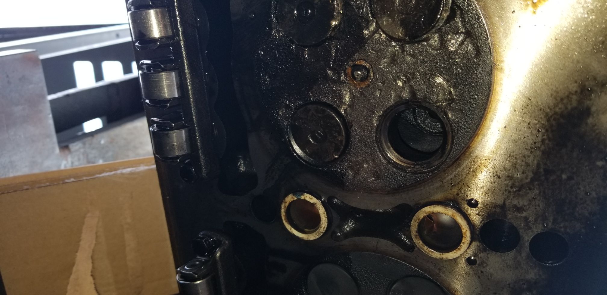

    Machine shop recommended
    Against the head rebuild...they would have to build metal up around the valves where it was hit. Said they would do it but very limited ittry ed warranty...biting the bullet for a new head...mechanic said he would check bearings anyways while he is in there and replace if necessary so i.got that covered also

    Head must have really been eaten up past the vale seats.
    Yep, It's gonna hurt the wallet but you will be far ahead on a new head.
    It's great to push da throttles up with confidence.
    If your tech with the bore scope is still available, pull the air covers and look up to the other engines valves and liners.
    Hot valve seats are easy to detect. Polished liners also.
    May save another head if you look and determine today or this fall to rebuild or reline the other engine.

  8. Capt Ralph
    14,575
    Yep, reef material.
    Have your shop find or order a whole head and not a blank.

    I'm confused...what is it I'm looking at in the above picture? Roller bearings?
  10. Capt Ralph
    14,575
    Click the picture to see it all.
    You will see where 4 exhaust valves should be surrounded by a smooth surface.
    1 valve missing and a smooth surface lost also.
    The valve dropped into the cylinder and was beat to pieces between the piston and head.

    Ahhh ok. Yes, clicking the picture made all the difference.
