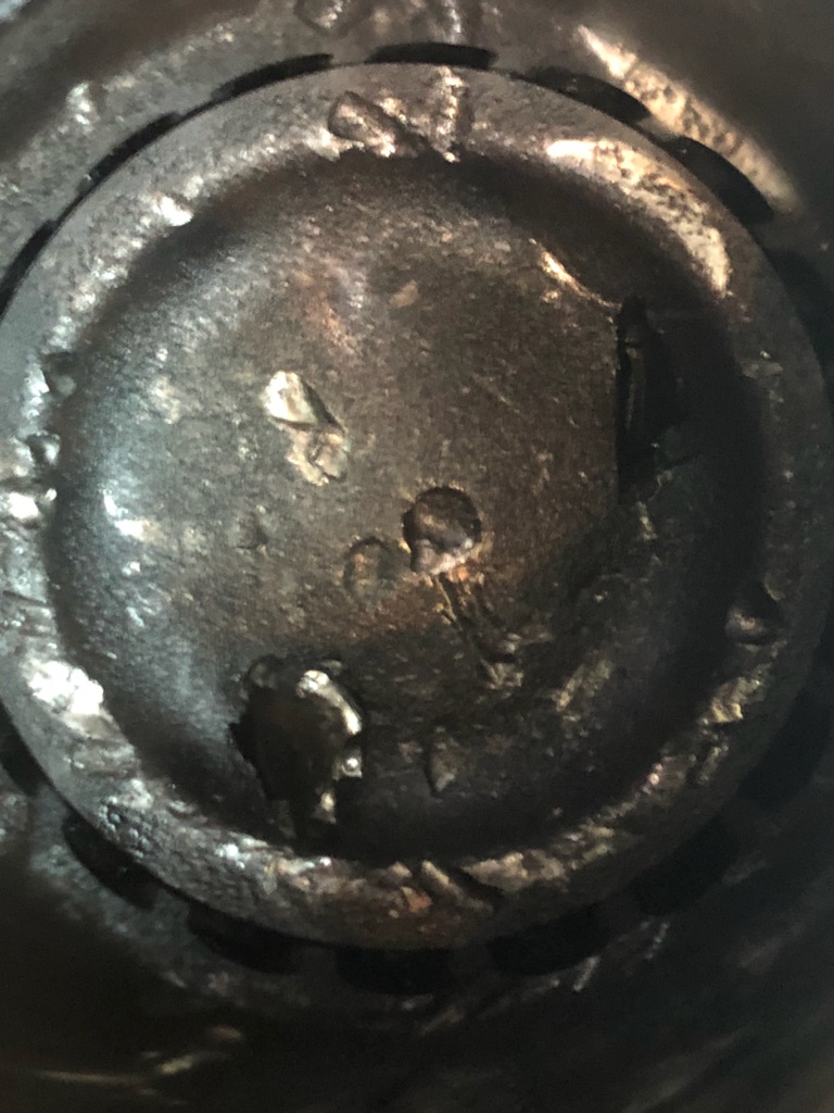

  11. Boomer

  12. Boomer
    Boomer Senior Member
    Oct 14, 2017
    677
    Seminole
  13. Boomer
    Oct 14, 2017
    677
    Seminole
    Yup...its broken...
  14. Capt J
    14,434
    Looks like you dropped a valve and it bounced around on the piston for a while.

  16. Capt Ralph
    12,727
    That's one injector that needs rework. Find a shop that can fix injectors and have all pop'd to match.
    Later 71 heads (4 valve) really need to be looked over very well. For me, I'd get a new head.
    Maybe a new rod with the piston/liner kit.
    New chunk for the turbo also.
    How does the other lungs look?
    I don't see any cross hatch pattern on this liner.
    I recall you commented the engine lost a great deal of oil.
    Large amounts of oil is shot up under to piston to help cool it. In your case, sucked rite thru that hole and out the exhaust.
