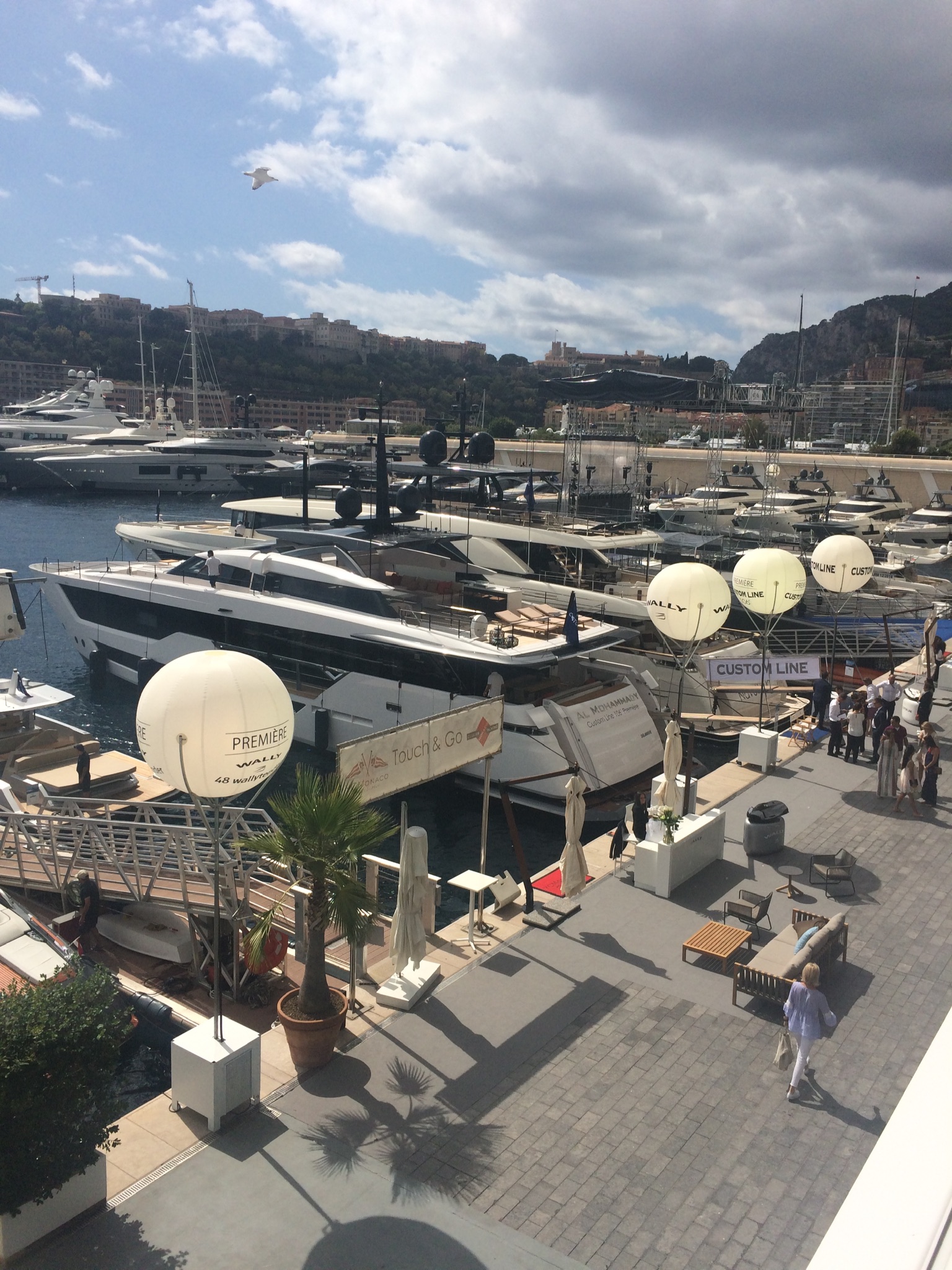

    FWIW from circa 2018 all Ferretti group plastic boats across the range are transparent Vac bagged .They then after quality control spray paint them .
    Even Ferretti beige as well as Itama blue .
    I was at the Monaco yacht show on a blue Itama and enquired about an alternative colour Was told any RAL number as everything you see here ( the whole range inc Pershing, Riva etc ) were ALL sprayed inc the blue Itama I was stood on .
    For the very reasons discussed here .With the gel coat colour you cannot easily pick up post Vac bagging defects .They occur with the best technical prep .
    It’s the paint tech that has come up so much so it looks like gel coat colour.
    Good to hear and see in the flesh .
    I did poke about and tap it with my finger nails looking for paint clues , but I will be dammed if I could tell . FAE1B63D-3A37-4D10-A68C-655898E44D8C.jpeg
    Every boat you see is clear Vac bagged , then painted after .
