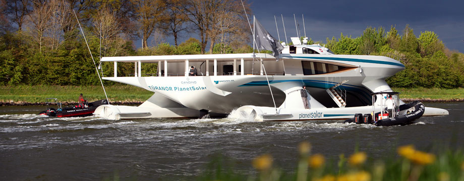

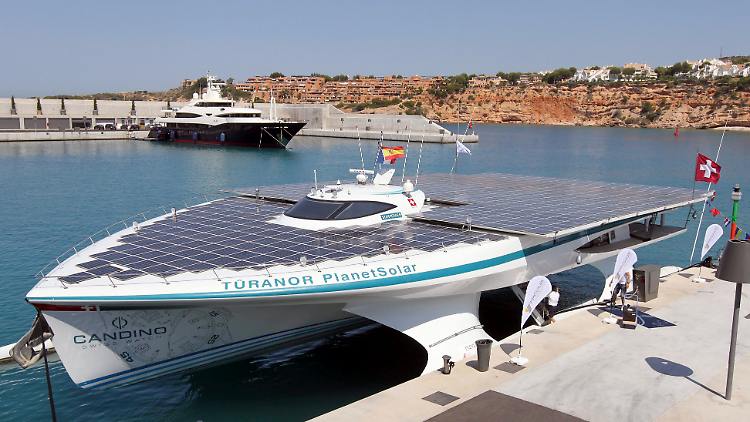

    It can be done and has been done before. Just google Planet Solar.
    This is the solar powered boat that crossed Oceans only under solar and battery power. The picture was taken at Port Adriano at Mallorca, Spain.

    yes indeed...I ve followed the progress of that boat.....but to create that large surface area without too much weightpenalty....$$$$$$$$!!
    I remember the budget for that boat was in the millions...over 10m?... but close anyway......but tenniscourt and a Helipad can be provided for.

    Turanor Planet Solar was built in 2010 at the Knierim Yard on the Kiel Canal in Germany. This yard is famous for very innovative one off projects.
    This project was the combination of a lot of the state of science regarding solar technology, electric energy storage and electric propulsion. Especially the large, slow turning surface propeller were top notch technology.
    A two masted Dyna rig combined with this technology could easily make up for a app. 24 meter pollution free long range motor sailor. And this boat would even be usable under the practicable point of view.
