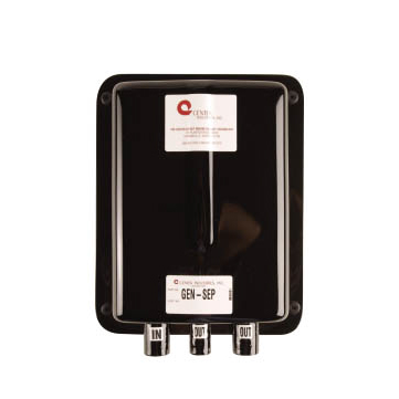

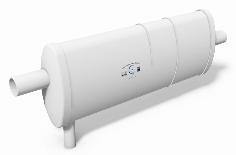

    Installing new 20 & 12kw diesel NL gen-sets.
    Because of limited room in my customers forward machinery space, I would like to build custom glass muffler-gas-Sep units.
    This would be a combo wet muffler with a next stage gas sep.
    Here the water drains below the hull and the cooled exhaust gasses blow overboard. Super quiet.
    In searching the web for models to compare to, I think I can figure water depth (weight) vs in-let and out-let.
    I just could use some reinforcement on the internal plumbing.
    Centec and others make them, just not accommodating to my area to install
    I want to make my own to fit the area I have. Could use a peek inside one to ensure I'm on a correct path.
    Anybody been here before?

  6. Capt Ralph
    12,753
    Lets try this again, expanded.
    I have installed the basic gas sep box. it is installed after the usual water lift muffler. I have a grasp on how it works. These customers are happy. A two part system that eats engine room space.
    I have installed one vertical combo muffler and gas sep unit. It muffles and then separates the exhaust gas from the water. It worked very well. I have not a clue how it is internally plumbed. I can guess, probably close but not to depend a build on. However, I do not have the height for these.
    Then, there is a horizontal combo muffler and gas sep. I have never installed one, further no clue how it's plumbed internally. This is what I need to build in what confines I have.
    Need more data or internal plumbing lay-out to confirm my theory before I build the first prototype.
