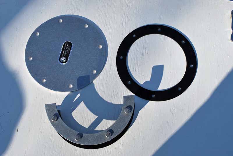

    We have a plastic tank made of a lower tank and upper tank that are joined via a. 3" 90 degree. Something has fouled the bottom exit pump out path. It will take forever to remove and re plumb all the fittings. I want to cut an access hole but concerned with being able to properly seal a plastic tank.
    Keep in mind the access needs to be in the lower tank which will have positive pressure once it fills and starts filling up the upper tank.
    Suggestions on how to seal up such an access hole? On a time crunch to get this fixed before boat gets loaded.

    You very likely would need to seal it up with a mechanical plate and gasket arrangement, I'm not sure if there are products you can install without access to the inside. That might leave you with a cleanout access plate if you can make it work. Maybe a plate and gasket on the outside, and a pair of half-round nutplates on the inside you can hold with a string, through two of the four holes on each. Have to look around to see if such a thing exists.

    If by plastic you mean poly tanks not fiberglass then I would not cut anywhere but a time the top which won't work since you have pressure from th upper tank. The only way to really work with that material is the origianl plastic weld they use installing the fittings. Nothing really stick to that material. A plastic access plate will never seal reliably, maybe a SS on like pictured above... risky

    The roto-molded polyethylene fittings on these tanks are usually "friction welded" to the material. They cut a hole, and the fitting typically has a flange, and then is spun to the surrounding surface adjacent to the hole and then welds itsef to the surface material.
    Seen this at their factory: http://www.ronco-plastics.com/
    They offer the same inspection plates as noted above.

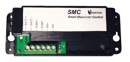

  17. Norseman
    Norseman Senior Member
    Feb 24, 2005
    2,931
    Going to try the Raritan pump and smart controller. Had Quality Raritan Heads in the past, high hopes for this combo.
  18. PacBlue
    PacBlue Senior Member
    Jan 9, 2009
    1,988
    Dana Point, Ca
    After all the recommendations for the Sealand Pump???
  19. Norseman
    Feb 24, 2005
    2,931
    Yeah. Wish I had asked the question a bit earlier but had already ordered the Raritan pump and the controller when all the Sealand recommendations started rolling in.
    Besides that, the Sealand pump may not fit, pretty cramped in the “Pump Room” on an Albin 28TE.
