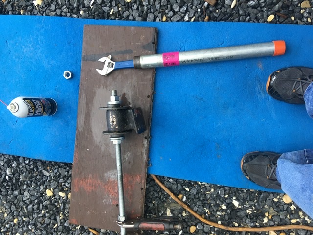

    Yes, I'm sure they would have! I got all struts off in 6 hrs...I should have called them to get it done the few days before...I am Meathead! Lol..
    Anyway, the second 6'' bearing when in quickly, compared to the first one. Tighten and tap with the hammer, really made the difference. The tap made them move.
    Not time to freeze them, that is a good idea.
    BUT, this is the last time I will remove and put them in. I will take them to the Machine shop in CM. I know for a fact they work on all kinds of marine stuff, shafts, struts, rudders etc...
    They straightened out my Chris-Craft Dory rudder last year when a sand bar jumped out at me going 30knots.:mad: AND I was in the channel...unreported or newly unmarked shoal .

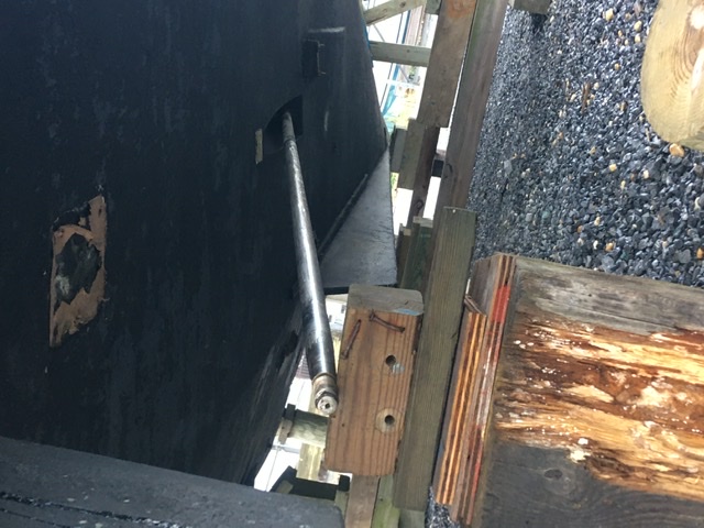

    5E2FE89C-3BC7-470A-B1D8-09F0DE8A313D.jpeg So J and CR are right some of the time...o_Olol!

    477232EA-B063-4B76-B832-7053A9A89BB2.jpeg FYI for you all to what’s going on.

    Aren't you skipping a set of bearings? In the stern tube?
  16. Capt Ralph
    14,585
    Don't think he has a bearing in the log. Hope not.

    Most small boats only have a stuffing box at the tube :) ...which is why I don't want to watch when he starts trying to wrestle those four struts with new cutlass bearings back into place on those free floating shafts.

    Are you planning to check the alignment? Rough it in while still on the blocks then final check and adjust after being in the water minimum 24 hrs. ?

    Yep no bearing in the shaft logs ; thank f&$@“?& !
    A little water down Dawn dish detergent and a clean shaft and all the struts went right back on I blocked up the shaft so they didn’t move.
    just had to twist and turn and pull with firm effort. Each pull I got 10” or so.
