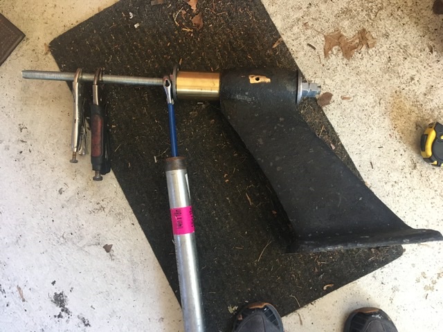

    today’s job is to install for Cutlass bearings , I removed all four struts from the boat and removed the old bearings yesterday the hard way with a saws all hammer and small chisel.
    no damage was done to any of the struts. BTW.

    I'm confused, did you remove the struts just to do the bearings? Based on the way you are doing it in the picture why did you need to remove the struts? And, since you have already removed the struts, why not just press the old bearings out and new ones in with a proper press? Any machine shop can do this easily now that struts are off. Or you could even buy a press at Harbor Freight for less than $100 to do it.

    They were easy to get to plus they had old silicon bronze bolts that were looking spooky so I dropped off four and left the Shaftsin the boat instead of pulling them out of the transmissions coupler andShaft logs.

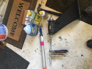

    Got one done ! Lol
    A little wrap on the side to her three times with a hammer really made a thing jump in an 8th to a 3/16 of an inch every time. Otherwise it would not budge.
    1.5” shaft bearings
    Tools used
    3/4 all thread
    3/4” washers
    1” floor flange
    Soap
    PB Blaster
    Olive oil...
    used olive oil on the all thread and the washers to help the nut turn.
    it was real important when things started to get tight to give the strata wrap with the hammer and you could see it jump in when you did that in my case.
