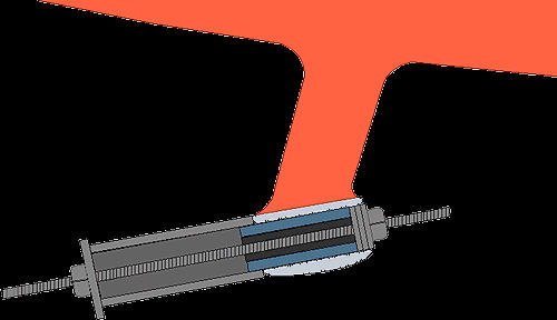

    Would a tool like this help at all??? I'm sure you could probably make this yourself. I'd be worried about using a hack saw

    You might want to check-out the non-hydraulic tool at strutpro.com. Looks like a simple, straightforward press. I've had zero experience at either this tool or replacement, just spied the advert in Sail.
