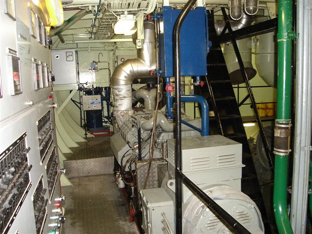

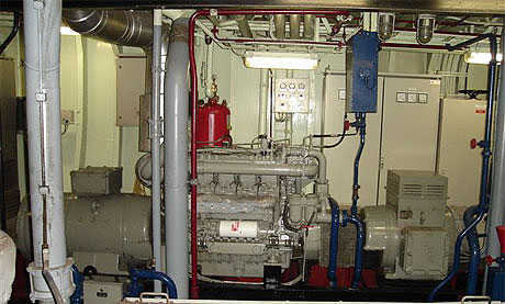

    Custom sound enclosure for Deutz
    Well, this is not a typical generator.
    It's a Deutz 1015C engine, driving a A/C generator on one end and a DC generator on the other end (for bow truster).
    So, not a stock item. See attached pictures.

    Hi Thorwald, for sound encloseres, you could check:
    www.marquip.nl and
    www.deruyterdieseltechniek.nl
    De Ruyter also composes "custom" gensets for shipbuilders by assembling the appropriate engines and alternators, so it should be possible to get yours classed too if it is not already.
    If it's below 100 kW, it's probably not even necessary.
    Bruno

    THanks Bruno,
    I had already found Marquip but the other is new to me.
    Indeed, I learned yesterday that my gen. set don't have the be classed.
    I'm not sure because it's below 100 KW or because it's a yacht application.
    Bedankt !
