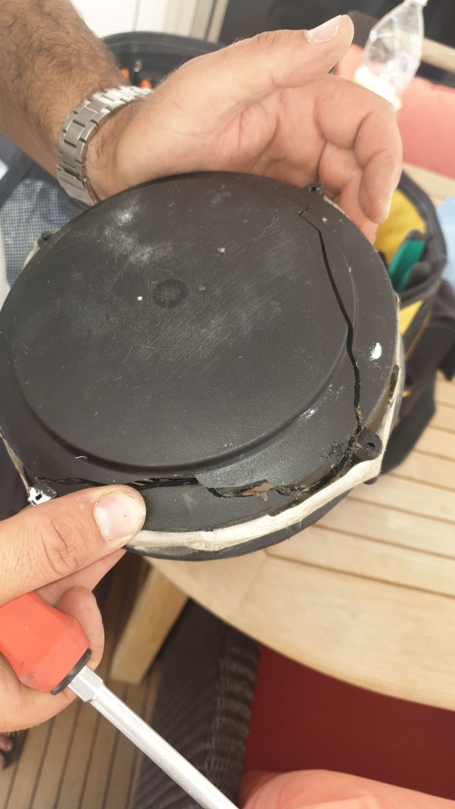

    We own an Azimut 43S and are looking for a replacement lid for the grey water tank.
    Does anyone know where we can find one?

    I've never seen a tank with a lid like that. Have you already tried Azimut or one of their dealers?

    Can you search the tank for any manufacturers markings or the lid itself? I've never seen that style lid before, but someone other than Azimut made that tank.

    What holds the cover to the tank?
    Perhaps a picture of the area with lid off.
    Might help us to provide an alternate method without to much effort for replacement.

    MarineTex.
    It s just a sump cover.

    Ok you re right. West system Epoxy with filler :)

    If the material is a polyethylene type of plastic, there is no hope of finding a durable adhesive. You may look at some of THESE and see if they may be similar. That company may be a good resource for other parts, as well. They are a major European supplier.
    If it is a poly tank and there are no manufacturer's marks on it to follow up, then the simplest solution would be to replace the existing cover and hole with a Beckson type access port.
