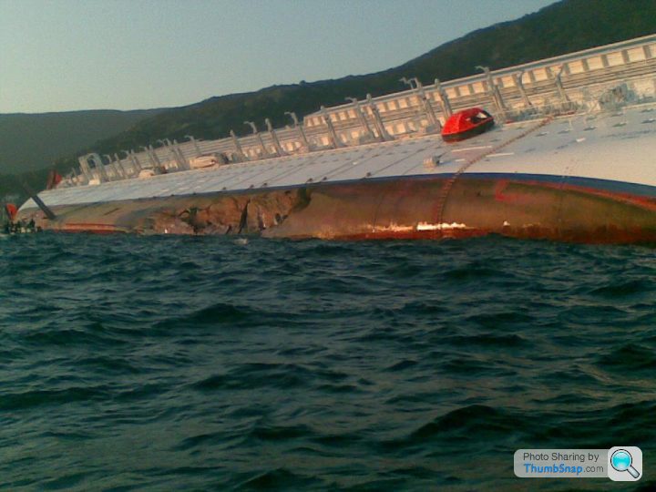

    Picture of the damage from a lifeboat.

    She has five sisterships too. They may be looking very closely at the design.

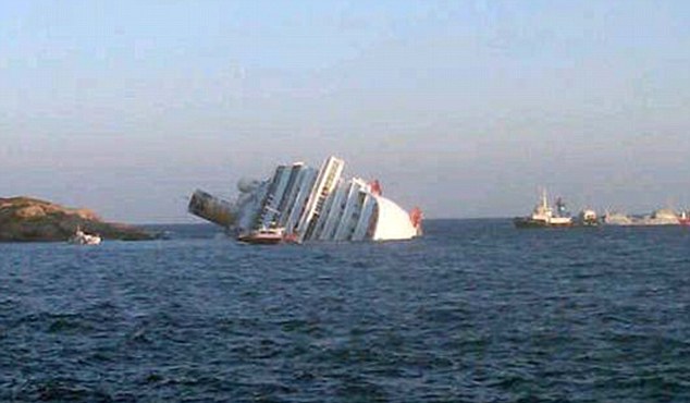

    Following the accident I wonder about 2 things:
    1) Refering to the picture of the ship, how cann it lean to one side and the rocks be visible on the other side? It somehow looks like the ship either ripped the rocks off and lifted them (unlikely) or the go through the ship???
    2) As there are some professionals on this forum, what map did they use and is or is not the rock on this map?
  17. Innomare
    Innomare Senior Member
    Dec 5, 2004
    233
    Mountainguy,
    To answer your question 1)
    This would be my reading of the events:
    After the hull was ruptured, entering water gradually reduced the stability of the (then still upright) ship. This is in large part due to the free-surface effect of the water. At a certain time, the upright ship reaches a point of negative stability and will tilt either to port or starboard to a point with positive stability again (apparently 20 degrees list in this case). You can compare the state of negative stability with a stick that you're trying to balance on the palm of your hand.
    So it's basically a matter of randomness that the hull tilted so that in the end, the rupture would come above water (at 20 degrees, the opening was still below the waterline, and stability further decreased with incoming water, until full capsize resulted).
