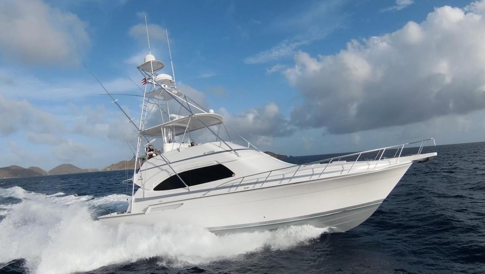

    Each to their own but here's photo of a 50 with repainted stripes similar to mine. Used to also mix black & white Micron 44 to create that grey on previous Bert but later learned the darker the bottom paint the less growth so changed back to black.

    I like the grey stripes and bottom paint.
