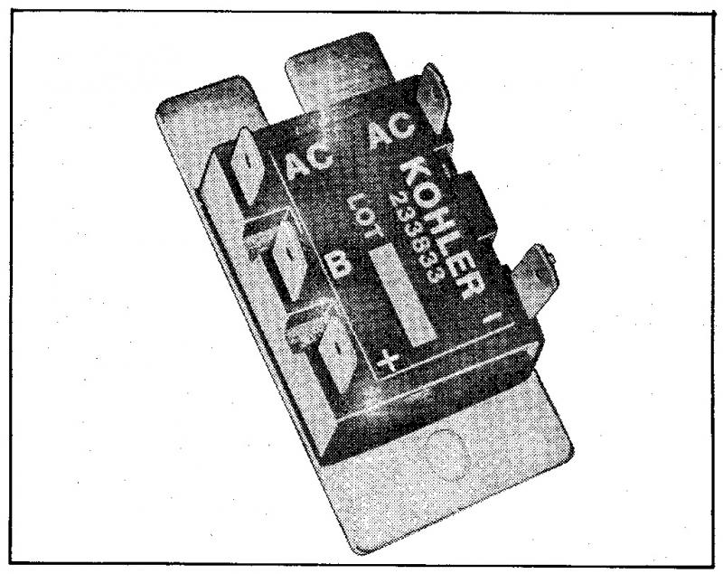

    Okay, just venting a frustration here. working on my Genny I found the mother board to be fried and an electronics expert told me the cause was a faulty voltage regulator, he was right, New Mother Board, $180, okay! But the voltage regulator! Holy Jesus! $384 for this? it is literally is the size of half a snickers bar, and of course the original is discontinued and the new kit is more expensive. I know it's a "marine" part and you always pay more, but JFC! You're Killin me Smalls! Okay, I'm done for now.......It's just the prinicpal
      94.3 KB
      874

    Are you positive that item (a rectifier, not a voltage regulator) is defective? It is just a bridge rectifier with 4 diodes and possibly a 5th to serve as a "flashing" source.
    Find a troubleshooting guide or service manual that tells you how to bench test the rectifier.
    It gets expensive when you start throwing parts at a problem.

    Hey Phillip, If your rectifier really is toast, how about sending it to me. It may be possible to reverse engineer the thing.
