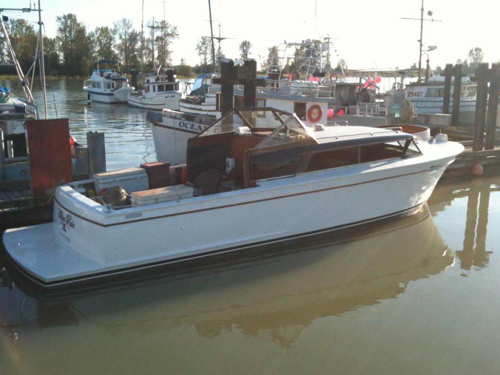

    030.jpg Here is a pic after hull rebuild .

  15. K1W1
    7,435
    Boat looks good but where are the before and during pictures lurking?
  16. *JU
    *JU New Member
    Feb 16, 2010
    27
    MN, AZ
    Very sharp looking!!!!
    I love the flowing stripe around the molded swin platform....very custom looking.
