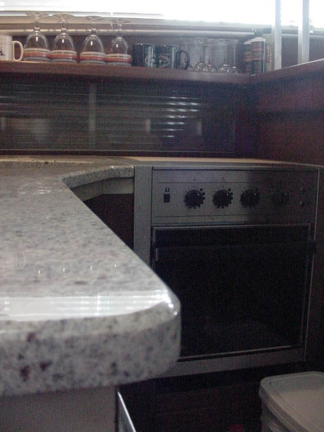

    Chris Craft Commander with granite galley
    Some people simply prefer plastic composition material because it's warm to the touch, softer in appearance, and easy to work with. However, I'm a firm believer that the real thing is always more stunning in appearance and often function too. If I can put down 3cm granite in a smallish 38' boat, I don't think the weight would a real factor in a much larger boat.
    Here is an example of a retro installation done on a 40 year old Chris Craft, ( I hope the photo meets the requirements of the forum, it is 121KB on my computer, so it looks okay).
    So as to not load up the forum with photos, I am referencing a link to where you can see several more photos of this particular installation. Real stone.........."there is no substitute".
    Granite galley upgrade
    http://www.network54.com/Forum/424840/message/1128230965
    We looked long and hard to find a granite that actually had some grain in it, hand selected the slab, and asked for our template to be cut from a specific area. Most granite is quite uniform in appearance, marble is easily damaged from impact, wine, vinegar, etc.
