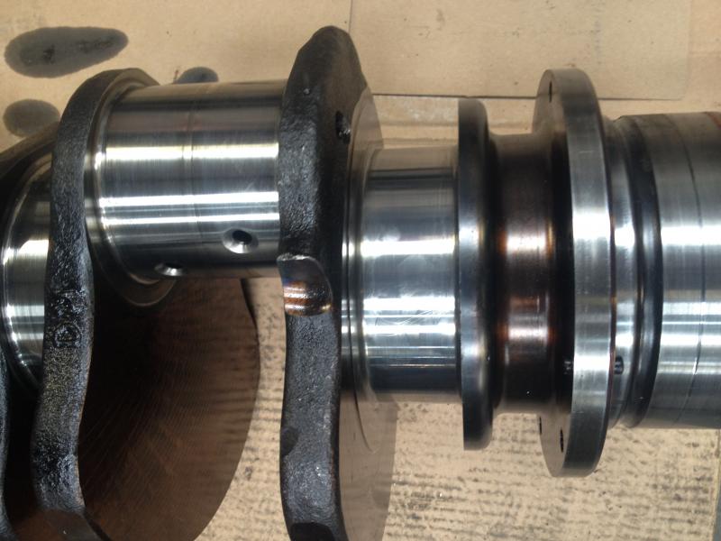

  9. Capt Ralph
    14,547
    Is that a balancing grind on the crank throw or did something hit it? If collision, with something, scrap the crank.
  10. K1W1
    7,453
    If it got that dent from striking something the shaft might be bent which might explain why it spat the thrusts out.
  11. Capt Ralph
    14,547
    Yes, If that is a strike as it looks like it in the pic.
    I have never seen a balancing grind in that area before but I am not the 92 crank expert. If it truly is a strike, in my opinion, not repairable, no matter what your machine shop may say. There are too many vibrations already going on in a DD 2-stroke. You don't want to go thru this again. Toast the crank.

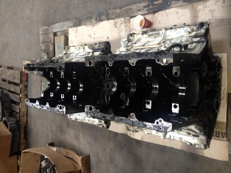

  12. bluesuit
    bluesuit Member
    Apr 15, 2013
    71
    new orleans
    here's a pic of the block.
    the gouge in the counterweight looks suspect to me.

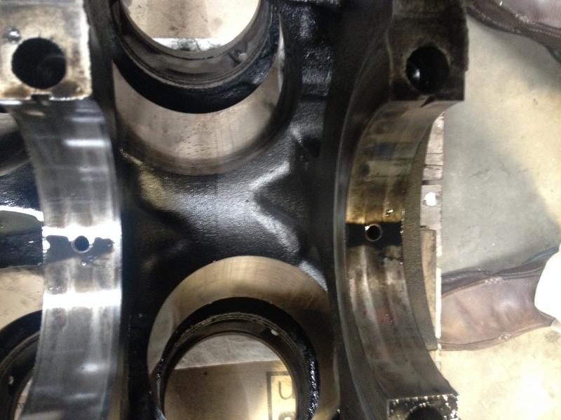

  13. bluesuit
    bluesuit Member
    Apr 15, 2013
    71
    new orleans
    better pic of the block
  14. K1W1
    7,453
    Hi
    When the main brg shells are out is there any signs of fretting on the back or a lot of wear on one side of the bearing surface?
    If it were mine I would check the alignment of the block even if I was going to junk it just to see if I could find something definitive to blame for the thrust coming out.
    I have seen an engine rebuilt without thrusts by its Owner, the clutch was always going out of adjustment and there was metal in the oil. By the time the fault was discovered the retainer slot for the thrust was badly worn. The Owner operator did not have the cash for a new block so we drilled and screwed the thrusts onto the block. Never heard any complaints or problems in the next 4 yrs I worked in that shop.
  15. bluesuit
    bluesuit Member
    Apr 15, 2013
    71
    new orleans
    yes, more wear on one side of the shell than the other.
  16. K1W1
    7,453
    If by this you mean fwd or aft side not top or bottom you have a bent crank.
  17. Capt Ralph
    14,547
    Wow. What an adventure.
    I'm not sure where that (suppose) strike on the crank came from. Was there a previous failure then slapped back together? I would not think a flying bearing part could do that.
  18. SomeTexan
    SomeTexan Member
    Jun 20, 2013
    189
    Texas, landlocked for a bit longer...
    There is no reason for that to be a balance mark, you always add/remove metal from the counterweights when balancing a crank. In the pic, it looks like it was made by solid contact with hard parts. I have seen a broken pushrod do similar damage in a different engine, makes me wonder what these engines have been through prior to your ownership. I am with everyone else, I wouldn't reuse the crank.
  19. Jimbo1959
    Jimbo1959 Member
    Aug 16, 2010
    77
    Stockton, CA
    I too would not use that crank, I would exchange it with recon from Detroit. As to the block, it should have those recesses at the rear main brg area. Those recesses are there to hold the upper thrust washers. But I see you have split the blocks apart. If those 2 blocks check out, you will need some special tools from DDA to assemble the blocks back together, very critical procedure for securing the blocks together. If your guy is unsure I wouldn't try it. BTW Detroit makes oversize thrust washers for blocks that have been machined.
