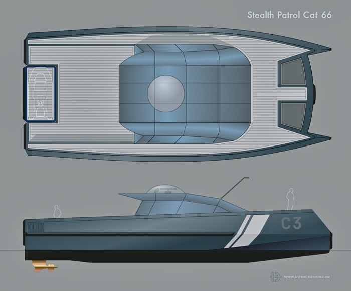

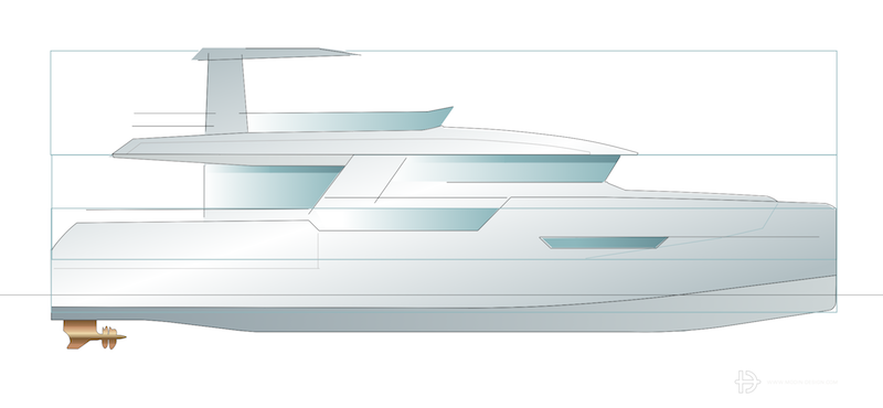

    You are right, I have a few similar designs in my files, like this 55 Hybrid Carbon Cat...
    My latest cat however, is a little more adapted to todays situation...

    305AA97F-D763-45E3-8D00-99A3803B9419.jpeg Lars: Not much reserve buoyancy on the C3 bows?
    I would think that design would stuff the bows even on a good day..:(

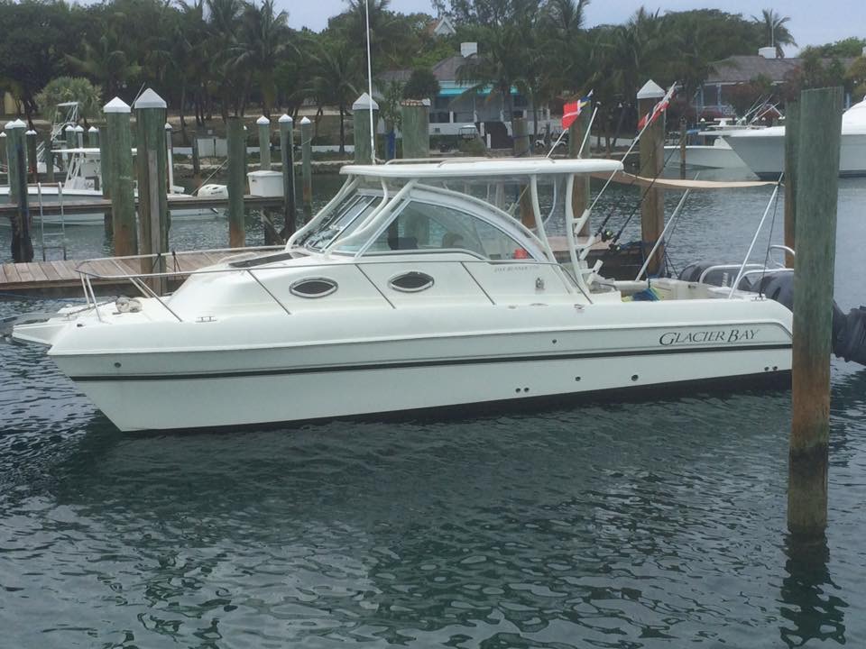

    I did occasionally on my 2016 Glacier Bay 2770: Going into the weather at slow
    speed leaving Fort Lauderdale for the Bahamas, at the inlet, both bows would
    submerge and the foredeck would scope up cold salt water and deliver it in the
    wheel house where we had the small front window open for ventilation.
    The crew and the electronics would be drenched in salt water and I would curse the glamours World Cat advertising promoting the cats as a magic carpet ride in rough weather.
    Not impressed and I sold the 2770 after 18 months with numerous trips to the Keys and one Bahamas cruise. (Needed seat belts for the Gulf Stream crossings.)
    The next boat, an Albin 28TE was better and more seaworthy for the crossings and it had more reserve buoyancy with a flared bow.
    What say you Lars?
    Are Clipper Bows out of vogue despite the benefits of buoyancy if you stuff the bow in bad weather?
  4. AMG
    5,380
    This depends on a couple of things, I think. Let's say that the bow line starts at the present waterline and sloping forward, this will extend the deck and add some buoyancy of course. If you instead start at the deck level and sloping back in the same angle, you will lose buoyancy compared to the design I have. The second thing is of course the weight, we are building in carbon fiber and the protruding parts will be empty. I have also added a chine line to deflect the spray, which is not so common on plumb bows, perhaps because designers are looking at sailing yachts design..?

    Yes, this is the classic Clipper Bow: The buoyancy would increase as the bow goes down into the ocean.
    A catamaran would look weird with 2 clipper bows, but it sure would keep the deck from becoming a water scoop.?

    I owned the Glacier Bay/World Cat for 18 months and realized it was perfect for
    high speed cruises in Biscayne Bay: It would handle light chop really well and
    run at 33 knots if needed, but I didn't enjoy the 2 screaming motors in the back doing high speed for hours.
    (Guess I am still a sailboater by heart: Cruise in peace and quiet with style..:cool:)
    Sold the 2770 after 18 months ownership and got more than I paid for it brand
    new. (Still in shock)
    All good, no regrets, but the Gulf Stream crossings was no match for the little cat despite the hype.
