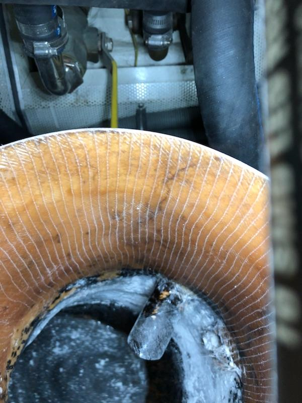

    You brought up a subject that is more fact than theory. A wet exhaust is like an air pump every time air pressure changes, wave action, or temp changes it is pumping air and moisture. Underwater exhaust is by far the worst. Block heaters or oil pan heaters are pretty much it, short of heating the engine room to high temps. Like the oil pan heaters such as SeaEric uses, simple and not immersed in the coolant. He also uses them 24/7/365 for about 8 years, so they must be durable. Personally I would use a higher wattage to get the engine temp up high enough to cover the wet exhaust moisture in the cylinders you mentioned. The bonus is taking care of high humidity and condensation in the er, better for electricals and corrosion. It would be great if all we had to do is run the engines every two weeks, but I still like having a dry er.
    A pic while of our underwater exhaust while doing some exhaust work.That is the water level at the bottom of the fiberglass tube.Every time the boat rocks it pumps moist air towards turbo, valves, and cylinders with open valves.
