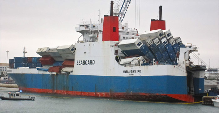

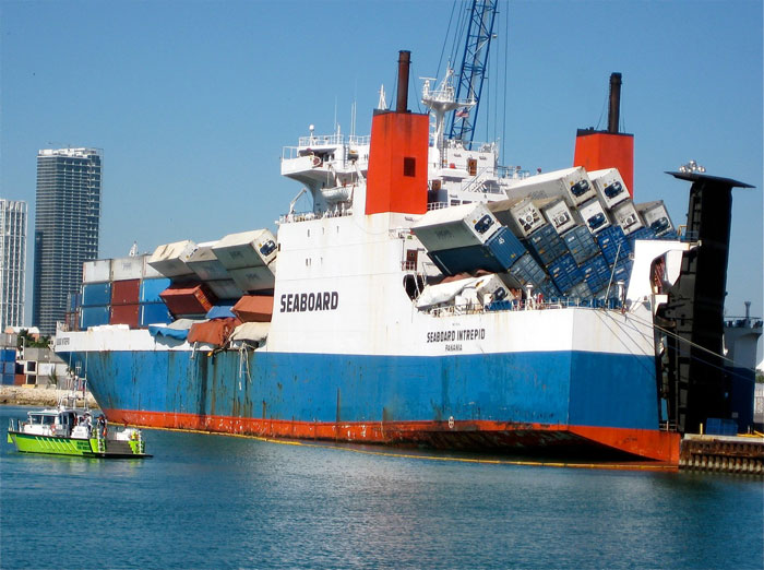

    Apparently, this ship arrived in Miami last week with containers falling over. How many didn't arrive?
  2. Capt J
    14,435
    Wow, what a mess! I wonder if they weren't secured properly (don't think so). Or what kind of sea they got into to dislodged all of those. Imagine the change in balance when they all started breaking loose.

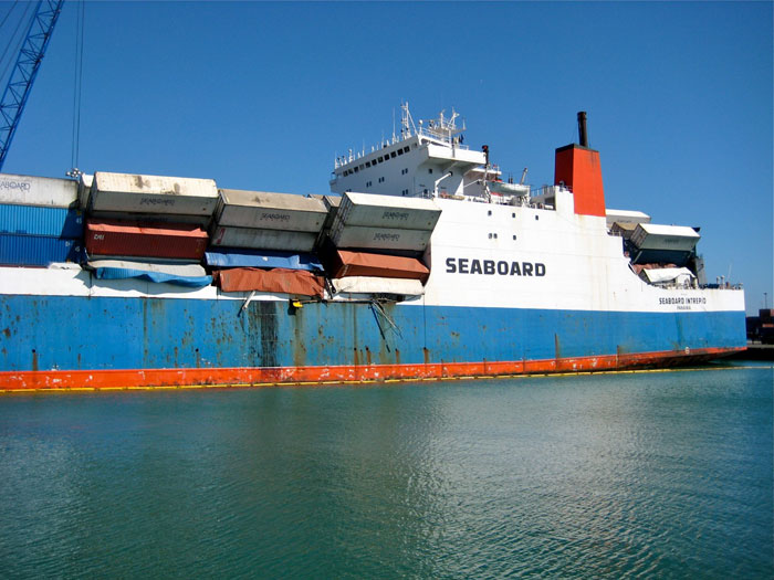

    From the coast guard news posted 1/26/10
    http://coastguardnews.com/coast-guard-responds-after-30-containers-fall-off-container-ship/2010/01/26/
    "MIAMI – Coast Guard crews are responding to a report Tuesday of about 30 containers that fell off the deck from Seaboard’s 544-foot container ship Intrepid, approximately 30 miles south of Key West, Fla., Monday."
    "The Coast Guard advises all mariners transiting through the area to proceed with caution and report any container sightings to the Coast Guard."
  5. Pascal
    8,170
    there were securité calls by sector Miami this week end about loose containers between here and FLL... they must be further north now if still afloat...

    Just a quick newbie / rookie question .... Is that a normal design for the port stern bottom to be out of the water, in a mostly loaded condition? Or is that a shadow?

    No, that's the way it's designed to work so there is no bluff underwater transom which is high drag. When the boat is running at sea speed, the stern wave will be right there.

    Would a large wave on the starboard side cause this? If it did it's a miracle she didn't roll. I would hate to be the crew.

  16. Marmot
    Marmot Senior Member
    May 20, 2007
    3,311
    9114 S. Central Ave
    Both. A shipper may request below deck carriage, but for the most part stowage location is based on regulations related to the contents of the box and the shipping company's convenience.
    The mate or other crewmember does not determine container location. The mate will check to ensure that the stowage plan provided by the shipping company is in compliance with regulations and the ship's particulars including stability on all legs of the voyage. The shipping company (ship operator) reserves the right to stow the container where it wants because it is impractical and expensive to move a container multiple times. All stowage plans are based on lifting and placing a container as few times as possible as port stays must be kept to a minimum and when a box going to the third port is in a hold above boxes going to the first and second ports the time to offload and reload is unacceptable.
    This highly choreographed movement of boxes is a pain in the butt for those of us who sail on boxboats because the days of long port stays are long gone.
    It doesn't take a giant wave to lose containers. Containerships are prone to a motion called parametric roll in following or quartering seas and thi can impose enormous forces on the "lashing gear" which holds the boxes to the hatch cover.
    I was on an APL ship off Vancouver Island heading toward Seattle from Japan on a fairly normal day for those parts, not too rough, a typical large swell but nothing particularly worth mention. I was in the house and heard what sounded exactly like the noise a train makes when the engine takes up the slack in a string of boxcars, kind of a 3 per second boom boom noise.
    I looked out my window and half the row of boxes (4 or 5 high) on the port side of the hatch next to the house was missing. The lashings had broken at the attach points on the hatch cover but, like in the picture posted here, the IBC's or interbox connectors (or twistlocks as they are also called) kept most of the boxes together and they went over the side in a large block.
    The amazing thing about all this was that there was virtualy no damage to the rail where they went over the side. This means the boxes had to levitate a few feet vertically(figuratively speaking of course since they stayed where they were and the ship moved out from under them) and move to port about 35 feet to land in the water alongside. In the seconds before and during the sound of them departing the ship there was no noticeable difference in the ship's motion.
    A quick run outside provided a view of a block of boxes and a few more singles sinking in the wake behind us. If anything can be said to be amusing about this was the sight of a pilot launch full of lawyers and surveyors meeting us at the pilot station. It seems that the boxes involved were full of very very expensive new electronics for which the shipper had specified below deck stowage.
