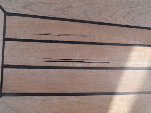

    Having bought a new OA and taking delivery in 2002, it has been nothing but a battle to get them to deal with multiple problems. There is a number of other owners I've been in contact with that have had the same issues of OA refusing to deal with their reacuring issues. I have spoken with multiple past employees whom also find it hard to believe how OA refuses to deal with obvious issues.
    One example is illustrated in picutes I would be happy to send to anyone considering. The pictures show the results of ONE sanding of the teak decks in the begining of the 3rd year. Obviously inferior planks were used and back filled with cauking only 1/16 inch below the surface. Their response on all issues is to stall, bs, and deny what they are looking at. They have developed a bad reputation and deserve it.

    With a 2002 boat you shouldn't expect thick teak. It's barely more than a vaneer on most boats built today. Personally, I can't imagine why a 'sanding' would be needed after only 3 years. Cleaning sure; brass wool maybe, but not sanding.

    Give me your email and I'll send you pics. If this is what a light sanding does, than why did OA just tell me a light sanding each year keeps the decks last longer? No one expects vaneer decking at that optional price.

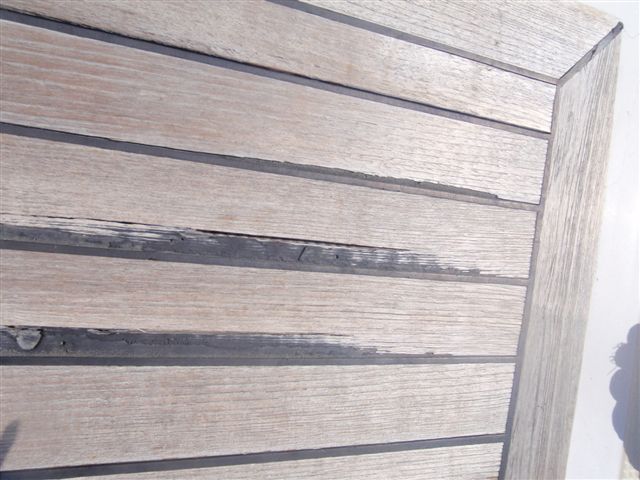

    Someone gave you bad advice. When you sand you take away wood. First off is the pours that hold your oil. In Florida you probably need to oil it monthly, and once a year or so clean it with chemicals (depending on use). If it gets to a point where that doesn't work use brass wool to get into the pours. I once watched a guy using a power sander on an older Post's cockpit cap rail. After that oil only stayed on for about a week. There's a couple of good threads here on caring for teak. Check them out.
    In the old days teak would be 3/8" to 1/2". You won't find that today with the price of teak unless the owner has money to burn. That also may be the source of your problems with OA, unrealistic expectations combined with a person that didn't know how to communicate with you properly, because they're a pretty good company from what I've heard.

    A thousand words
    see attached
  18. Mohawk
    Mohawk New Member
    Mar 29, 2010
    16
    Palm Beach, Newport Ri
    more pics 1/16 down

    7,435
    How thick is the Teak on your boat?
    I have seen light caulking deposits on teak exactly like your first photo after a first light sand on a new deck ( not sure how thick those in your photo are), they soon disappear when the sanding takes another cut off the top.
  20. NYCAP123
    11,210
