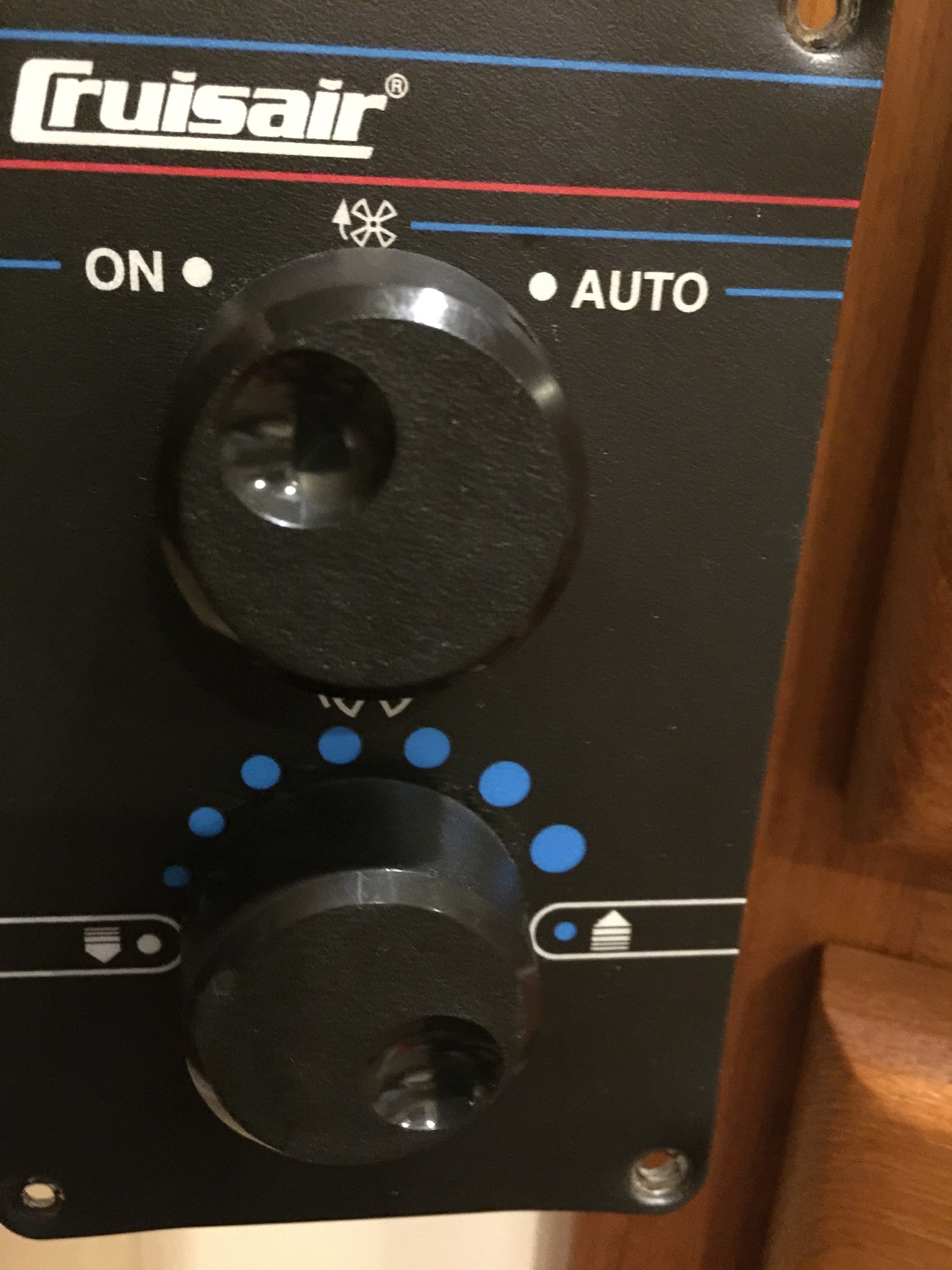

    I on the SA$A ZBC v berth ac control the bottom knob turns the fan up/down. I'm not able to tell a difference in the fan speed so not sure whether its on slow or fast. Is there a way to bypass or check the 230v rheostat? Can I wire it so that its running on full speed by bypassing the knob? With an ohm meter should I notice a resistance difference as I turn the knob.

    You can't use a rheostat to slow a AC motor. That will lower the voltage and burn it up. Many motors have 3 or 4 speeds using multi wire taps. A Triac "Modern dimmer" can slow a AC motor down. It doesn't lower the voltage , it changes the ratio of time on to time off to change speed. Think of turning a light switch on & off 100 times a second and the motor is at 100% speed. Now turn the switch on & off 80 times a second , the motor will be at 80% speed . Still getting full voltage. You can google Triac for more details on the circuitry.

    Maybe rheostat is the wrong terminology but it came with the cruiseair system. I'll post a picture.
