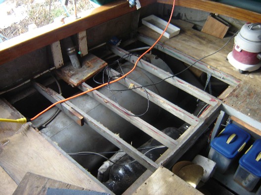

    Hello,
    I am replacing the back deck and some of the framing on my 27' 1962 custom comet, are the frames Quartersawn Red Oak, and does anyone see anything wrong with using the (new) coated deck screws instead of bronze or S.S., I am planning on sealing it with epoxy and having a thin coat of Rhino lining put on, becauce it will be used part time for Dive and Fishing Charters then a snap in carpet for Pleasure use.
    Thanks in advance

    Thanks for the info i just pulled the tanks last night, going to clean them up then inspect them, the outsides are free of rust i thought there maybe a small spot of corrosion in one but it might be just a little crud. we also do eddy current here at my shop so i can check the material thickness also going to put in fuel guages while i have them out. On the deck, i have talked to a couple of boat builders one of them told me any wood is fine and suggested douglas fir and the other one said to use white oak, i think thats the way i am going to go plus i think i will put a couple of coats of epoxy on it plus tape the joints because of the weight of divers and thier gear. What do you think of fastners? Bronze, Stainless or could i use deck srews since it will be incapsulated in epoxy?
