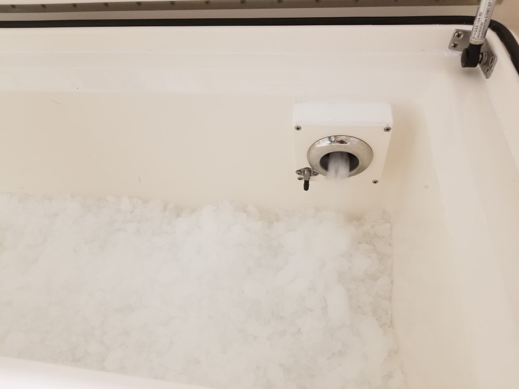

    The March pump for cockpit freezer had some junk in it but not sure if that is what did it in or not. Cleaned up sea strainer and installed new gaskets. Installed new pump and wow she runs smooth. Down to 11 degrees in 2 hours. All good.
    Eskimo is running but I think it needs an adjustment given our cold water temps. 55 degrees. I will leave it for now and move on to other items like installing Scotty downriggers so I can go fishing. I don't have a baseline for expectations yet so need to get to know it better over time to figure out what it needs to run better.

    FINAL UPDATE: All systems Operational.
    After another call with Dometic I did some addtl troubleshooting. I removed the current hose connection and hooked up a temporary hose and ran it straight into a 5 gallon bucket. Machine ran great and filled the bucket up with no issues. From this I was able to determine that there was a restriction in my hose between the Eskimo unit and fishbox. I hooked the hose on the boat back up and removed the first 18 inches of insulation so I could better monitor ice accumulation. I found that it worked fine initially but after a few minutes there was an obstruction or corner between the bulkhead and fishbox that I was blind to. I didn't want to remove the fishbox again and that wouldn't help me gain much access anyway. So we removed the hose as it entered fishbox and with some work we pulled as much out as we could out into the fishbox and came up with new connection at the side of the fishbox. That kept the hose as short as possible to reduce any bends and to give the ice a nice gradual bend into the box from the unit. I am happy to say that the system is now working fantastic. I ran it for 2 hours tonight with no issues. This entire situation has been good initial learning experience as it allowed me to better understand the Eskimo unit and what it likes and doesn't like to run properly. Dometic has been knowledgeable and helpful in educating me. Going forward I am planning to run the unit monthly to hopefully keep it running smoothly with descaler being ran through the system annually.
