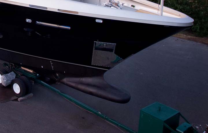

    they have used the same hull mould forever.. all the boats are based on the same adjustable mould. Some additional bow shapes are added to change the look of the boat but the underwater profile is the same.
    ( except for the bulb which is added afterwards)

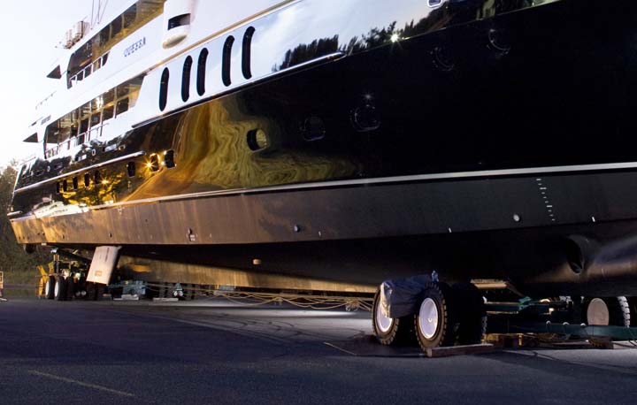

    Its not a great shape as its adjustable. I think for a 100-120 footer it would be ok, but on a 160 its stretched to the max and almost barge shape.

    Christensen uses only one variable geometry plug mold in thier builds . It can be made longer and beamier but from 140' to 165' same mold. They don't build anything under 140' in the custom series. I agree that they need to re-tool mold wise AND forget the aft engine room concept on 165' yachts , A midship engine room is the preferred balance point and deepest part of the hull for machinery installations.

    Head sea. Slams allot, throws unbelievable amount of spray. The bow is quite shallow and full so you end up slamming (not panting). and as its very full, at speed the bulb comes out of the water. The bulb is very very flat on the bottom this also slams. Its not comfortable going it head seas as compared to any of the others that I have been on.
    Following sea. Again as the hull is very shallow there is not allot of keel or directional stability. The boat has a difficult time holding course and tends to broach easily.
    Beam seas. Ok for the most part but again the hull is very shallow and almost a box shape. Very fast snap roll as any hard chine boat will give. But the flat section will occasionally get slammed by a wave.

    This is more smoked Gouda. The flat section is on top of the bulb! Hardly a point that would cause slamming when reentering the water. Personally I think Christensen's bulb is a work of art. It's an inverted semi-symmetrical wing shape that creates a higher negative pressure area above the bulb, drawing water lower along the waterline at the bow, substantially canceling the bow wave. The flat section on top of the bulb actually helps reduce pitch and heave.
    Look like plenty of keel to me, not to mention a hard chine adds directional stability.
