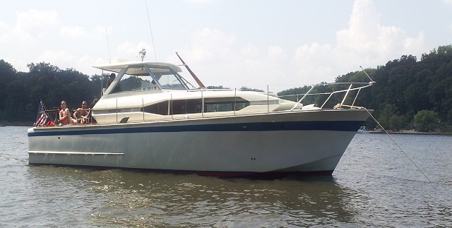

    Pics of the boat
    I just noticed that Alloyed2Sea posted links to photos of my rebuild (on 05-02-2012; hull # RXP 37-2509). I can report that after all that effort (and cost $$$$, ugh). She is done and beautiful. She runs great, too.
    In case anyone wonders: it took longer than expected, cost more than expected. However, it is a great feeling, running around the bay in a boat that I know is solid.
