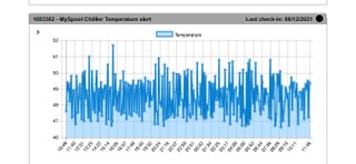

  4. Pascal
    8,948
    Update.
    i replaced one of the two sea water pumps with a rebuilt one 3 days ago and so far so good. The breaker hasn’t tripped and I have been able to get the loop at a constant 47.5 to 49 degrees since. Makes a big difference inside the boat. Obviously:)
    i m having another spare rebuilt as well and will swap it for the second pump, which I suspect also has a lot of erosion.

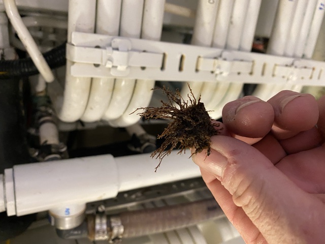

  7. Pascal
    8,948
    Breaker has been holding fine till last night after returning to dock. Quickly realized that the middle coil on chiller nr 2 was much hotter than the others. Each chiller has three coils.
    back flushing the whole chiller didn’t help has the water took the easy path they the other coil. Disconnected that coil and sure enough... this came out.
    In this case the coil was so hot that just touching them revealed the issue but other wise an IR Gun is a great tool. A few weeks ago I wrote the temps on the coils to have a baseline. Very useful.
  8. Capt J
    14,897
    OK, but bigger question, how on earth did that make it through the sea strainer?

  10. Pascal
    8,948
    Strainer basket had a small crack. It’s a plastic groco. I m ordering a new one and in the meantime used a zip tie to close the seam.
