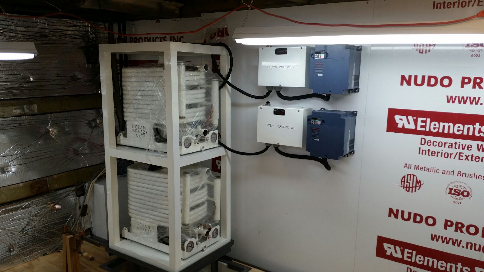

    Thanks for all the recommendations. My favorite quote from one of the techs was congratulations your chillers laster 18 years. LOL. The good news is that the chiller price from Ocean Breeze and Flagship are reasonable and less than expected.. Both are a little less than $7k per 5-tom.. All my Freq drives and pumps are working well so that saves a bunch. I do very much like how simple these units are that they don't rely on proprietary circuit boards. Almost all spares can be bought via Grainger. Ocean Breeze will also custom configure intake and output locations so that they match the existing. Lead times aren't as great with 2-6 weeks.
    There is some temptation to upgrade to 6 ton as its only $750 per unit, but there's a fear that the plumbing might not be sized, etc.
    I'm still reviewing options so I'll add more info as I get it.
    As for the the failure.... the old cruiseair brain looks to be the culprit. We lost water flow to the units which should have caused the low or high pressure switch to shut them off. However the brain didn't and blew a couple fuses. That's the best guess why both would let go at the same time.
