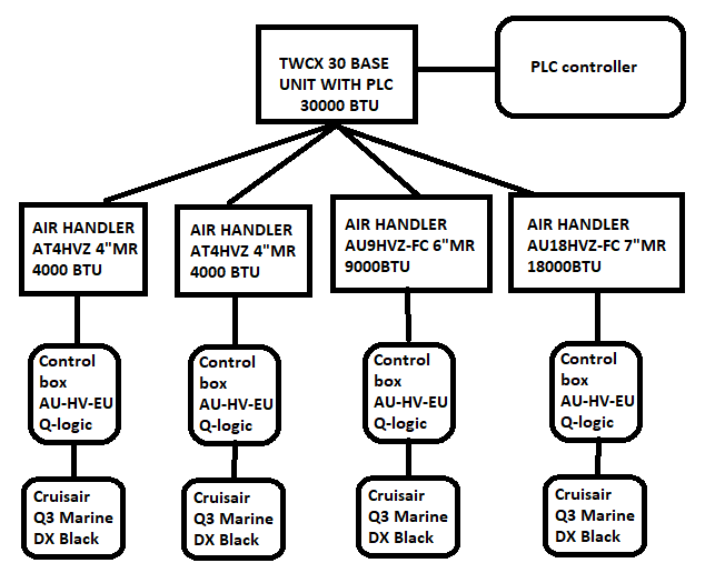

  8. nguyentu
    nguyentu New Member
    Mar 10, 2020
    Vietnam
    Hello guys,
    I'm a beginner. I'm planning DOMETIC's chiller system for marine.
    Diagram:
    Chiller modular and 4 air handler: they are good for me
    4 x (control box Q-logic + Cruisair Q3): Is that the best choice?
    PLC controller: Does the chiller modular come with a PLC controller? or Will I have to buy an additional PLC controller? Which model do you suggest?
    All of these devices are enough for a singer Chiller system? ( not include: exp tank, pump, flow control, other accessories,..)
    Thanks!
  9. Seasmaster
    Seasmaster Senior Member
    May 25, 2016
    294
    USA
    Can't answer the question without knowing more.
    * Are you replacing a system, or starting from scratch?
    * What/where will usage of vessel be? If you only have 1 chiller, and it dies in the Bahama summer - you will be one miserable boat owner.
    * If you haven't started discussion with an AC contractor, you are already behind the 8 ball. And the AC guy can directly answer your PLC/Q-Logic/Cruiseair Q3 questions.
    I'm not an AC guy, but the first thing I noticed is that your AHU total BTU's is higher than what the chiller will produce. Will that guarantee premature failure?? I don't know, but the AC contractor SURELY will.

    If all you need are 30,000 BTU's of a/c and 4 units, don't even bother with the complexity and issues of a chiller system, just put 4 all in one/package a/c units and be done with it.
