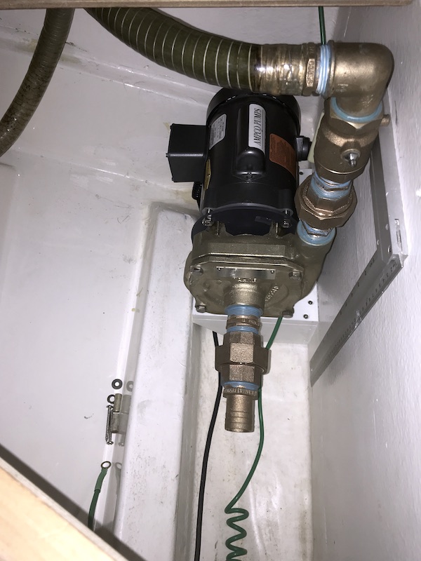

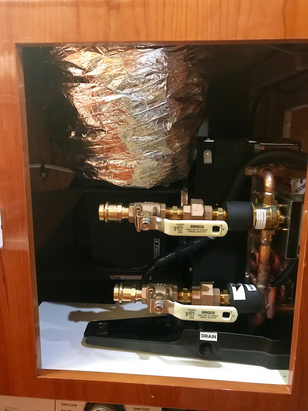

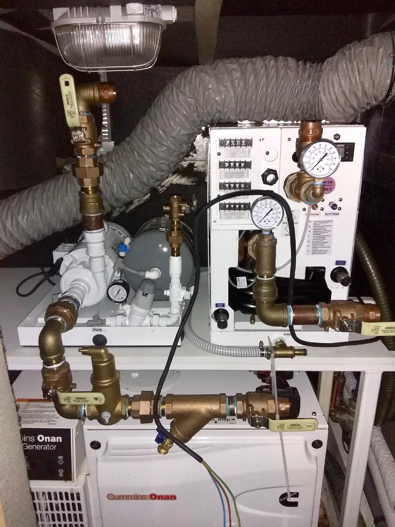

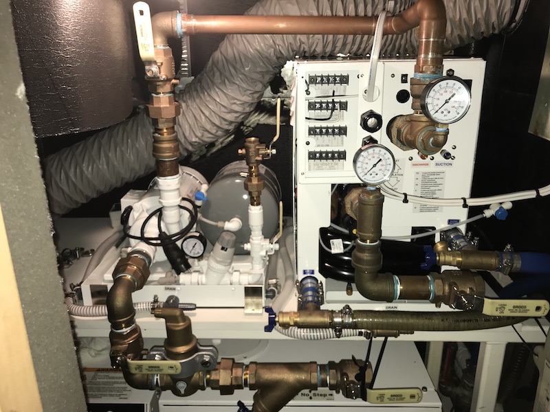

    Project coming along. Trunk lines run - not much to show in a picture though.
    Salt Water pump in:
    Chiller and circ pump before:
    Chiller and circ pump now:
    One of the AHU's "trial position": Plumbing to follow.

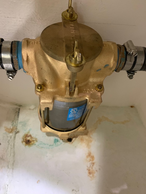

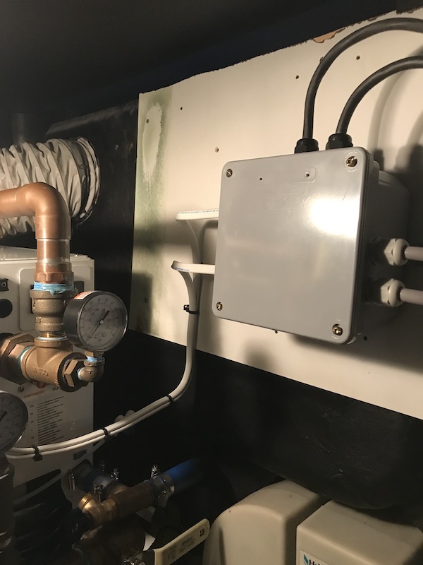

    Well, more progress on the project. Had to replace the raw-water strainer for the AC, and more piping on the chiller unit as well as a new electrical box to replace the controllers from the earlier chillers. The AC guy's been chasing electrical gremlins. See my post: "Foreign Wiring & Electrolysis". I might have Air by the end of the month!!!
    New box in ER, replacing old controllers.
    New piping
    New strainer
