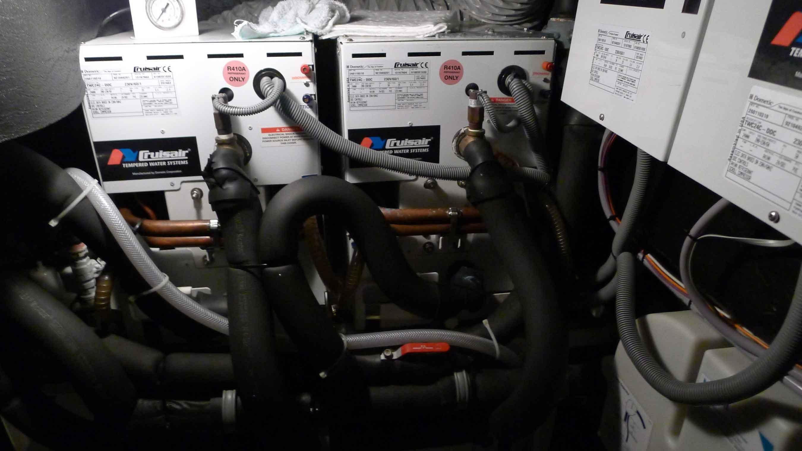

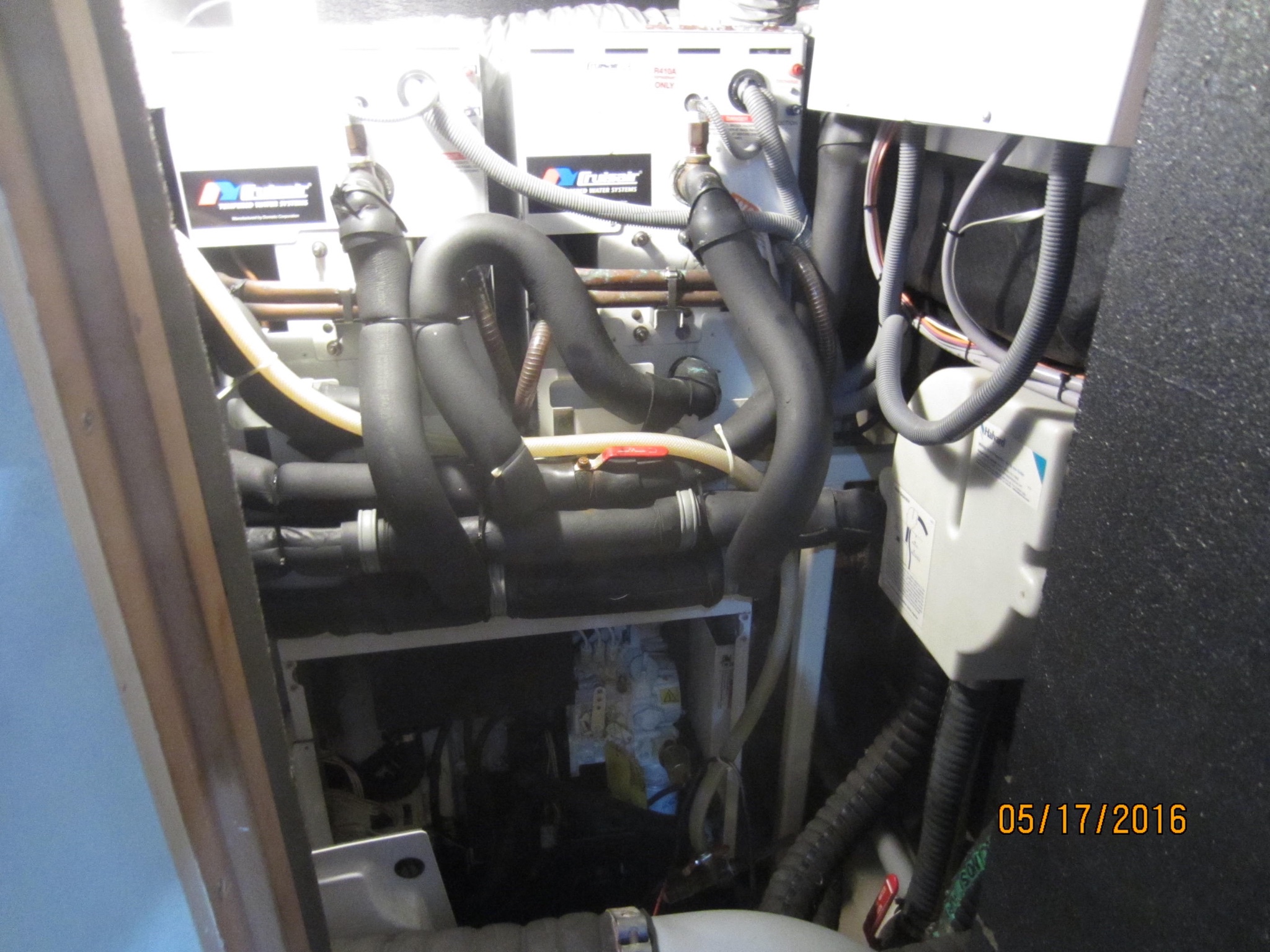

    I'm the third owner of a 2012 boat with 2 Cruisair [Dometic] TWC24's. They are shoe-horned into the space and sit on top of the genset, and just outboard of the main. As you can see from the pictures, room to work on them is negligible.
    The current [no pun intended] problem is when running the AC plant while underway and the space is hot, the Genset will trip off-line [engine running, not producing electricity]. I suspect that when one or both units start, the starting amp is excessive. This is a new problem, starting about 6 months ago. Note, when this occurs, I'm not using any other high-current appliances such as the cook top [230v], washer/dryer [120v], convection-microwave oven[120v]. Both the raw-water pump and chill-water circulation pump appear to be fine.
    I don't know the maintenance history of the units, and since the boat is almost 8 years, I'm considering replacement as opposed to a rebuild, since labor to remove/install is assumed to be about the same for either rebuild/replace. If I plan on selling the boat in 2 to 3 years, I believe I'm ahead by replacing now.

    Unfortunately your replacement options are going to be VERY limited because of lack of space. Shame on whoever built that boat. Personally that would be a deal killer for me. Going to a single chiller may be easier space wise but you will loose redundancy. Right now if loose one chiller you can still juggle cooling by turning off stateroom air handlers during the day and the saloon at night
    Upgrading to two 30k, if they even fit, will only increase Amps and breaker popping
    You shouldn’t have to replace the units
    Do they both start fine on shore power?
    Have you tried to put a full load on the generator using stove, oven, etc. to see if the breaker holds. Sometimes generators with dirty filter will stumble a bit when a load is applied. This results is lower voltage, higher amp and POP!
    When coming back from a run and the ER is hot, does the problem occur when on shore power. If not, then it s not a heat issue
    Try to watch the amp meter when each chiller starts.
    Could also be a bad capacitor.

    I would have soft starts on every chiller boat, as you have the seawater pump kick on and the chiller startup usually at the same time. The soft start modules aren't that expensive to add to an existing chiller.....$700-1000 usually.
    You really need to diagnose exactly what the real issue is before throwing 1000's of dollars at it. How long has it been since you descaled them? If they haven't been descaled in a long time, that will make them draw a lot more amps. Also, both chillers should not be kicking on at the same time, the startup temperatures should be about 2F apart. The boards are in the Dometic boxes in top right of the picture closer than the chillers. Loosen the screw, take cover off and there is a digital circuit board in there, this is where it displays error codes (HP/LP) etc. but also where you set the cut in/cut off pressures. Also, how long has it been since the generator has had both fuel filters changed as well as a tune up (valve adjustment etc.)? The first place I would start is putting a good clamp on amp meter on each chiller and getting it to cycle and seeing what startup amps it's pulling and what running amps each compressor is pulling. There should be a plate/sticker that will tell you what both "SHOULD" be. If 1 of the above mentioned items is not close to that you've found your problem. Next move onto the circulating pump and the sea water pump and test them. If all of those are close to rated amps, you really need to focus on the generator, check cycles and see what's going on with it. I agree with Pacal, if a generator isn't running correctly and gets a large load, rpm's drop too much, amps skyrocket and boom the breaker pops. If the chillers haven't been descaled in a year or so, I would do that too with the Trac fluid.
    If I was replacing them, I'd go with dometic, 2 units, and larger if you can go to 36k btu's with soft start compressors. That way the entire boat should run on one chiller, but you also have to have a good a/c guy check the system and make sure that oversizing will not cause the 1 unit to short cycle because the air handlers aren't big enough to utilize it. Before doing this, you really need to add up all of the BTU's each air handler is. What boat is it in? My guess would be a Neptunus.

    Your pictures show the newer 410 condensing stations. If there running at all, you have the best and probably just over due for some maintenance.
